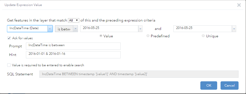

Is it possible to display the first couple of days of calls for service so that my users can see the last 48hrs by default? Then if they wanted to see something prior to that they can search for it using the filter. Currently, my users have to put in a date filter every time they open the application.

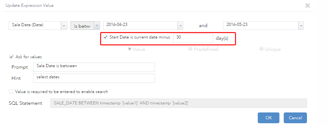

Actually I think you did fix it in your update. Only thing is, I'm not using the new version of esearch.
In your new version it displays the box that I am looking for.
Is there a way to add that option or upgrade my application?
