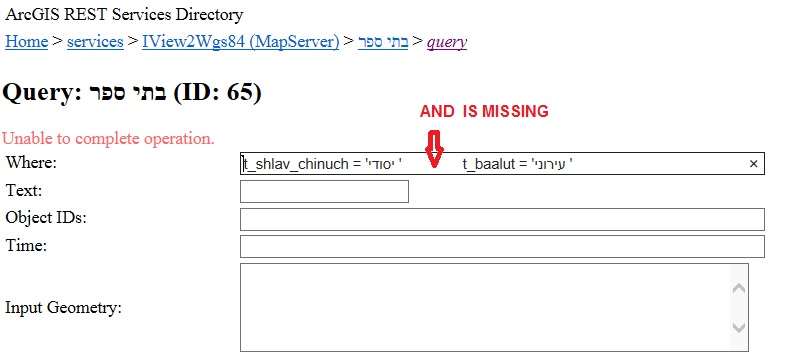

   You have some strange stuff going on in your SQL statement. Pleas start a new thread so you can attach your config_Enhanced Search.json

   Looks like I have issues in the widgets querying hosted services by date. I will have this fixed in the 1.2.0.5 release.
SuzyBrunzell
Deactivated User
Thanks for the quick reply – it’s good to know that it is my data and not me. We’ve posted the hosted service as a proof of concept while we are doing the data development for the version that will become the mapservice. I’m guessing that if I were working with a mapservice, I may not have encountered the issues? The shape query I can get to work, I have struggled with most of the value queries that I have tried to build.
I’m going to set this work aside knowing that it won’t work with the combination of data and widgets that I currently have available. I hope to have a mapservice by the end of the week and will pick with using version 1.2.0.4 then.
Thanks again for being so responsive.

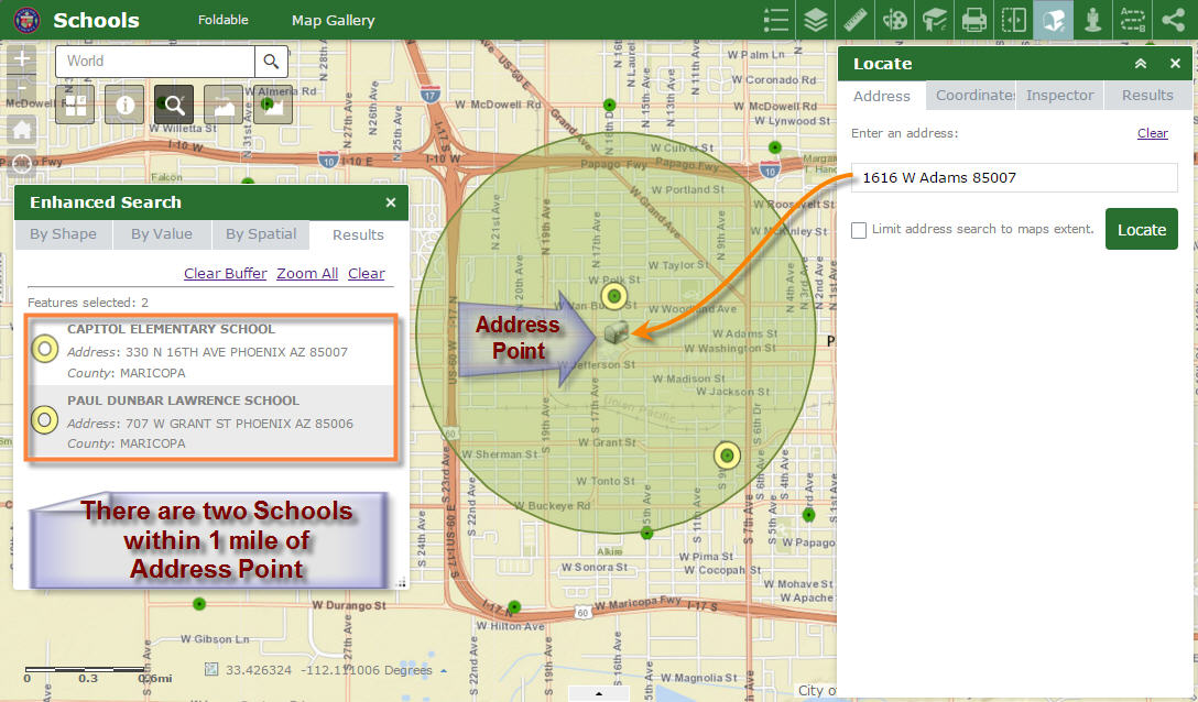

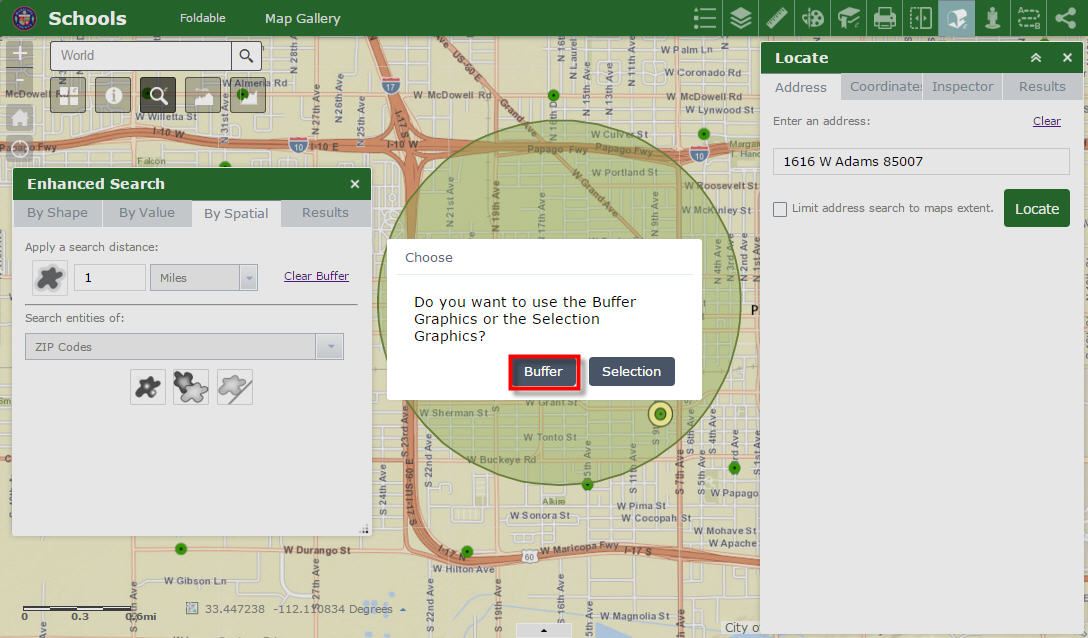

What I really like is how the output of the Enhanced Locate Widget can be used as an input to the Enhanced Search Widget.
This makes it very easy to find all the Schools within 1 mile of your Address Point with two mouse clicks:
  1. Check the Buffer Graphic option (default is 1 mile).
  2. Click on the Use Existing Enhanced Locate Widget Graphics tool.
There are two Schools within 1 mile of my Address Point.
This is the cleanest implementation for answering the most common question - search for the entities within 1 mile of my location.

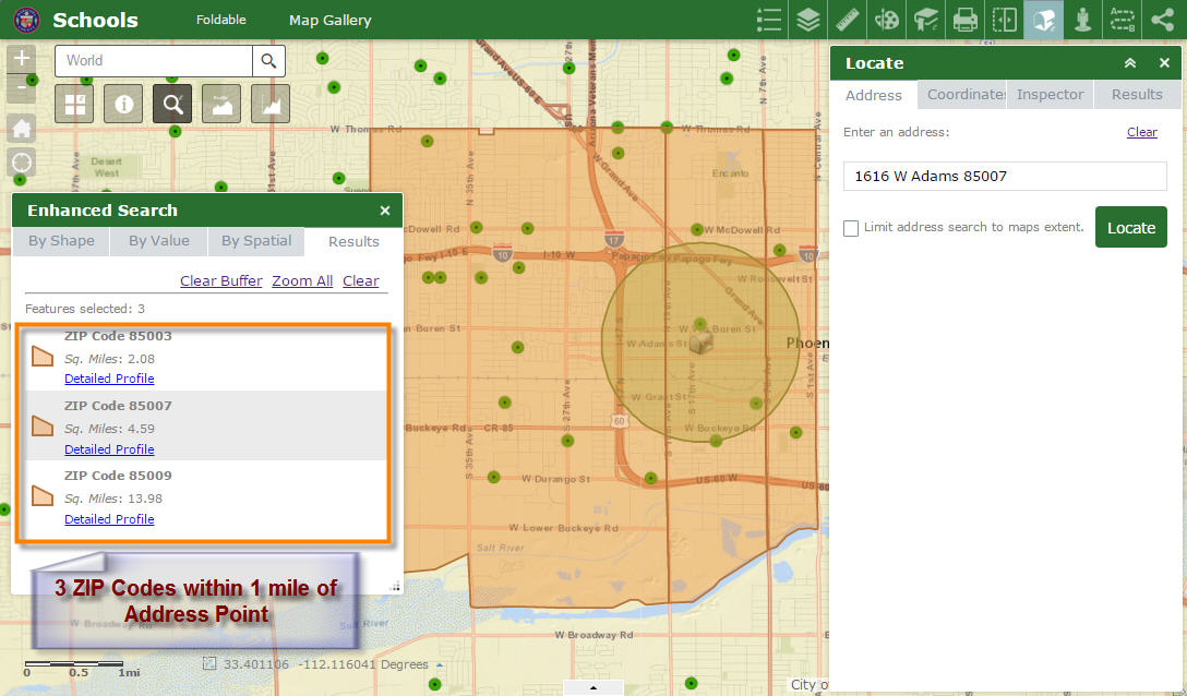

The user can proceed to run a Spatial Search to find all the ZIP Codes that are intersected by this 1 mile Buffer.
Select the Buffer option.
There are 3 ZIP Codes within 1 mile of the Address Point.
The user can also find all the ZIP Codes that are Touched by these 3 selected ZIP Codes.

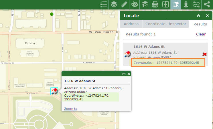

I like how the Use Existing Enhanced Locate Widget Graphics Tool remains hidden when the user has not yet located a point using the Enhanced Locate Widget.

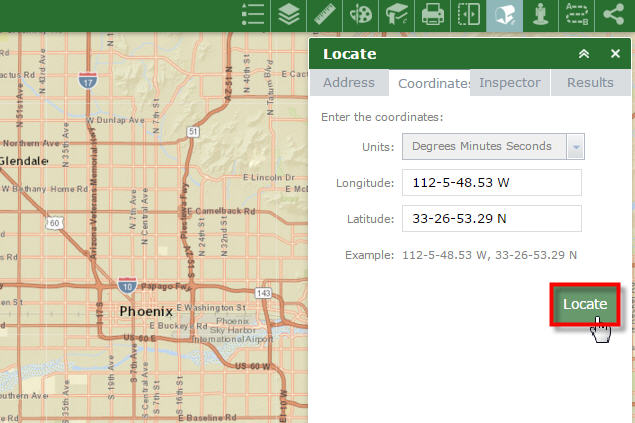

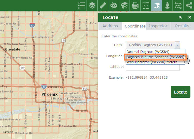

You have fixed all the related issues with the Degrees Minutes Seconds input.
The coordinates are being read correctly.
I like how the Use Existing Enhanced Locate Widget Graphics Tool appears when the user locates a coordinate.
When you  clear the results from Enhanced Locate Widget, this tool gets removed.
This keeps the interface clean.
This behavior is better than your Flex Version!

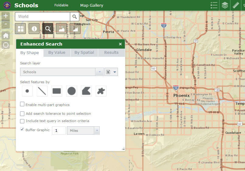

Hi Robert,
I like the clean readout from the Address Inspector Tool.
This is much better than listing separate X and Y coordinate values.
Your new options to Add and Delete from the currently selected set will be very useful.

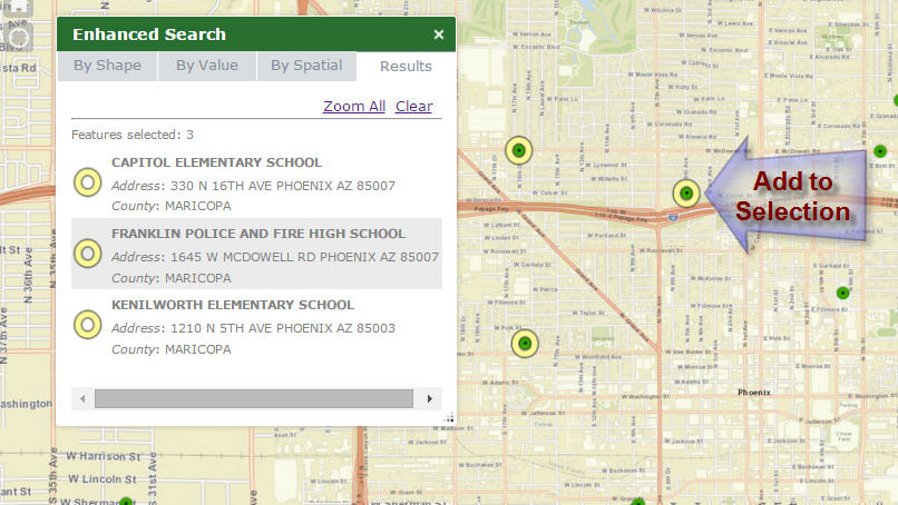

It all works like a charm when you are Selecting by Shape.
Here I am making a New Selection to select 2 Schools using the Extent Tool.
I am Adding to my current Results.
I am adding one School to my Selection.
I have a total of 3 Schools in my Results.
Now I am Removing from my current Results.
I have removed 1 School.
There should be (3-1) = 2 Schools.
The number of features selected is shown correctly as 2.
However, 3 Schools are listed in the Results Panel.

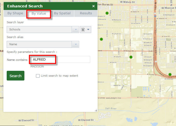

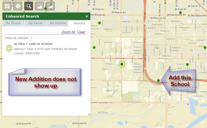

I am selecting a School by Value
Name contains = ALFRED
1 School is Selected
Now, I am opening my Shape Tab.
I am Adding to my current results (already has 1 selected)
I am adding 1 School.
However, the new addition does not show up in the Results Pane.

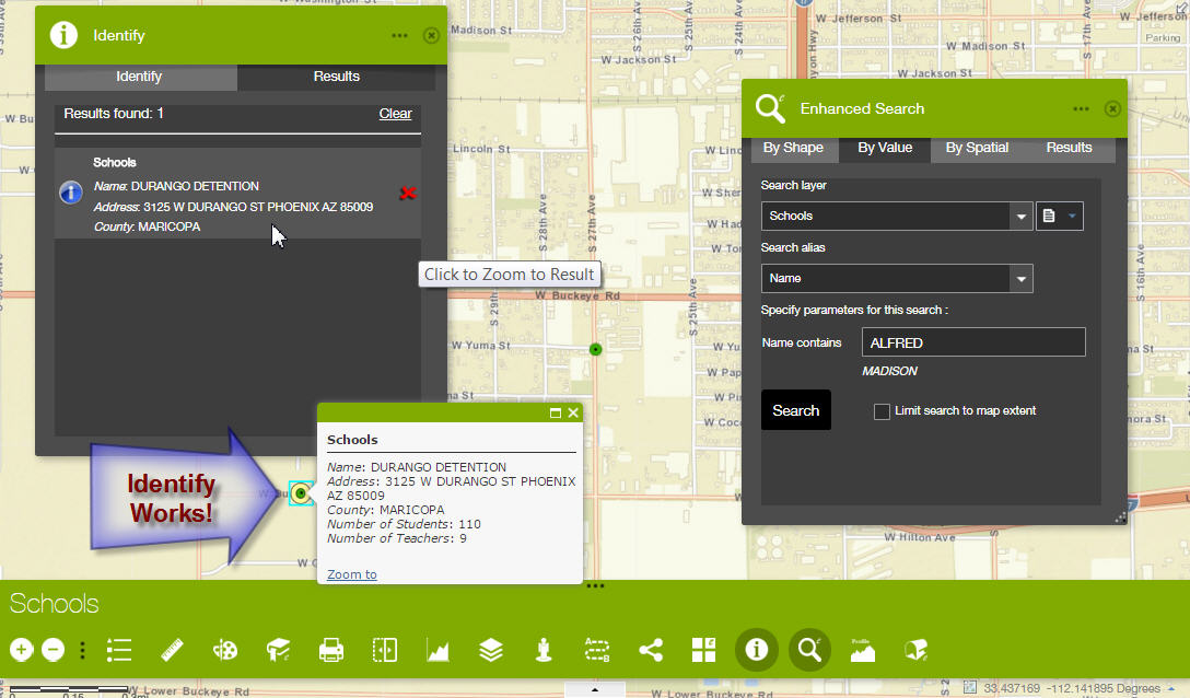

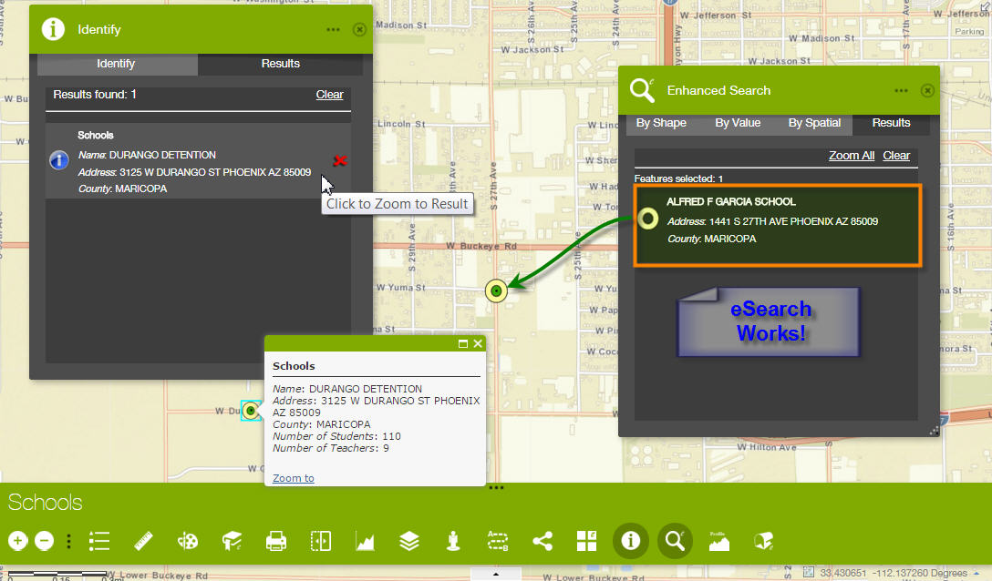

I wish there was a way to make the Identify and Enhanced Search Widget work independently with one another, especially while using the Dart Theme which allows you to have multiple widgets open at the same time.
I am using Identify 1.2.0.2 and eSearch 1.2.0.5 in this example:
http://www.tapasdas.com/Maps/Phones/app78
I am performing a Search By Attribute.
One School is found
Open the Identify Widget
Activate the Extent Tool.
  1. Select a School with the Extent Tool.
  2. The Identify Widget hangs!
The only way out is to Clear the Results from the Enhanced Search Widget.
Then, open the Identify Tab, and redo the Select by Extent Tool.
With the Enhanced Search Results cleared, the Identify works as expected.
This means the user has to remember, to clear the Search Results first before attempting to perform an Identify.
However, it is not necessary to clear the Identify Results prior to performing an Enhanced Search.
Click on the Search button.
The Enhanced Search works, even though the Identify Results have not been cleared.
It would be a nice enhancement if the Identify Tool could be made to work without having to clear the results from an eSearch.

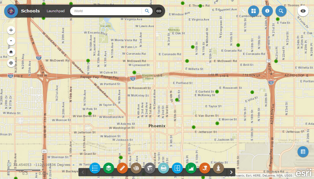

DAVIDDAS1
Hi Robert,
Here are the rest of my tests using your 8 Custom Widgets on the remaining 5 Themes.
Launchpad Theme
http://www.tapasdas.com/Maps/Phones/app77
This is the perfect theme to use on Desktops and Laptops where you have the screen real estate to keep multiple widgets open.
I like how all the Widgets can be resized, moved, and minimized.
I like how the Search Results can be displayed in the Attribute Table when needed.

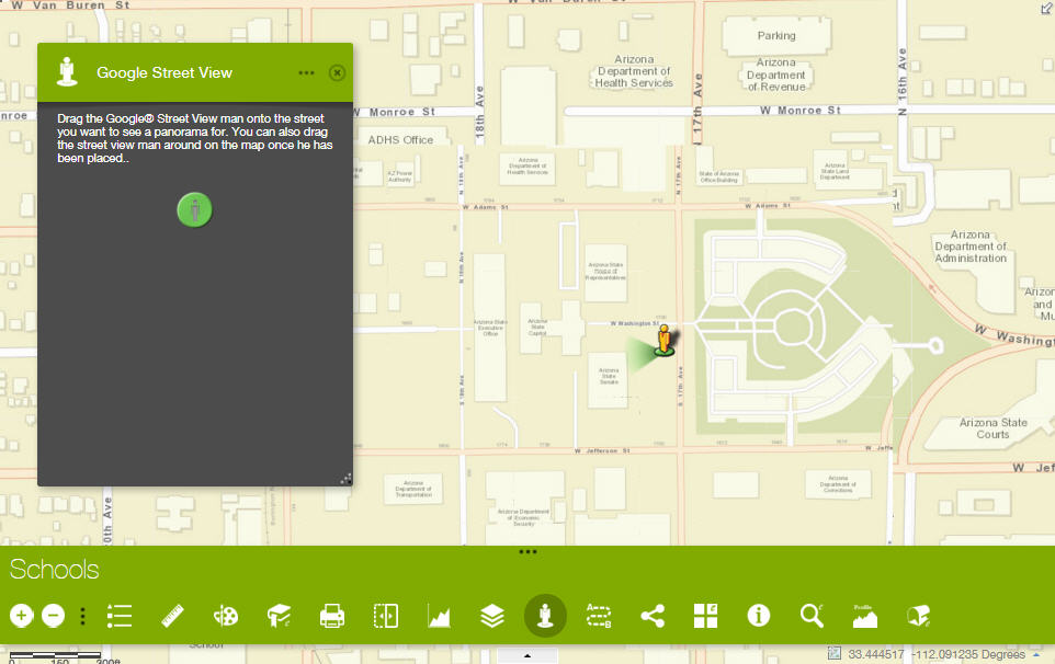

Dart Theme
This is by far the most stylish theme!
You have fixed the running text issue with the Enhanced Locate Widget.
There is no need to manually widen the widget to show all the text.
Your Elevation Profile Widget looks snazzy under this Theme.
I like how you have enhanced your Google Street View widget to follow the Style Color.
The borders matches the Style Color.

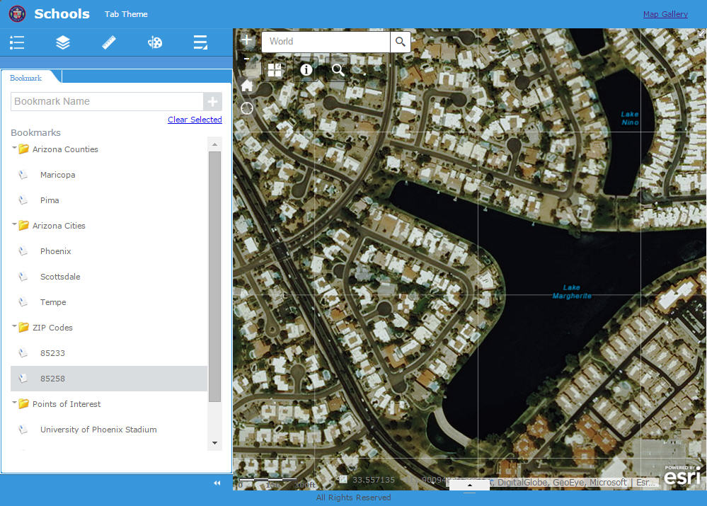

However, the Enhanced Bookmark Widget text is not visible.
Tab Theme
http://www.tapasdas.com/Maps/Phones/app79
Box Theme
http://www.tapasdas.com/Maps/Phones/app80
You have fixed all issues with running text on the Enhanced Locate Widget.
All the controls on the Enhanced Search Widget fits the width.
Jewelry Box Theme
http://www.tapasdas.com/Maps/Phones/app81

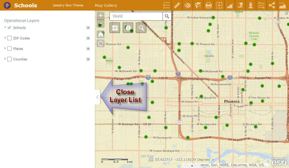

I like how the Layer List can be moved out of the way by closing the Left Panel.
Robert, this is an extraordinary amount of work you have done for our Web AppBuilder Community. These 8 Custom Widgets boosts the power and functionality of the Web AppBuilder platform to a whole new level.
I am amazed to find how easy it is to create these fully responsive designs in a matter of hours without having to write a single line of code.
Your GUI makes it idiot proof to configure these widgets. I find this far simpler compared to how we had to manually doctor the xml files in the Flex Version.

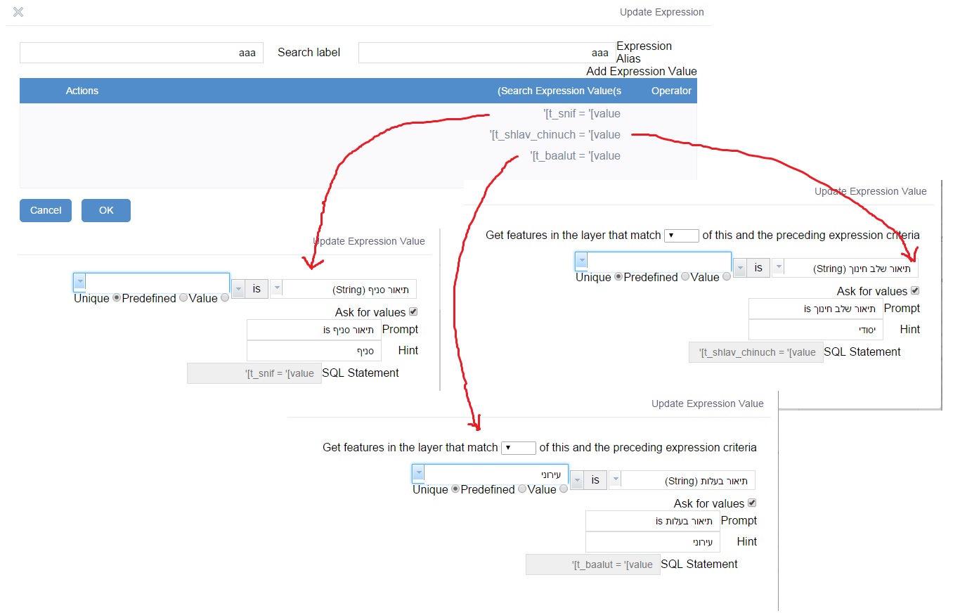

MiriEshel

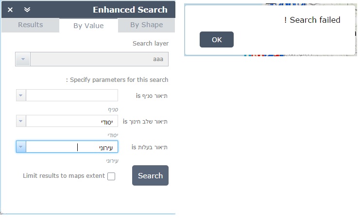

Hi Robert,
The latest enhancement of Removing required from all inputs unless the field is marked as required (#3 in your list) was so needed and I'm so happy you've added this flexibility to the widget.
What I found out is that when I ask about two fields or more, it doesn't add the AND between the different fields and therefore the search fails. As soon as I add the and in REST, it works.
I wonder if I use it correctly or it is some kind of a bug.
Thanks a lot,
Miri
RobertScheitlin__GISP
MVP Emeritus
Miri,
   This is strange what happens when I add a second expression value the "Get features in the layer that match  [drop down here]  of this and the preceding expression criteria" is set to "All" which equates to "AND" being added to the SQL. You can choose "Any" which means "OR" is added to the SQL. In your screenshots the dropdown is empty... Does the dropdown in your screen shot for the second and third expression value contain any text? It is suppose to default to "All"

MiriEshel
Hi Robert,
I would like the "AND" only on the fields that I enter value in the dropdown list.
All the other fields I would like to ignore.
In the next Query, I would select different fields so it gives me a lot of flexibility.
It works great, it just doesn't add the "ADD" in the request.
I can try doing it myself, I just wanted to know how it suppose to work.
Can you try select values in only part of the fields and see if you get a valid result?
Thanks,
Miri
MVP Emeritus
Miri,
   It does work in my testing just fine if you add a second expression value and it is not marked required and you do not fill out this expression value.
I asked you some questions in my previous reply can you please answer those?
by Anonymous User
Not applicable
Hi Robert,
I am interested in using this widget only for the Graphical search functionality. I had hoped I could simply point it to a map service that has around 50 layers, and it would have an All Layers kind of functionality, similar to Identify. However, I discovered I had to add every layer individually, with a dummy expressions. This is okay, however. I am just using a random field for each layer, with Ask for Values as an expression.
But, if eSearch could have an "All Layers" as the top choice in the Search Layer menu in the Graphical Search tab, that would be great. What do you think?
Basically, this kind of replicates Identify. ...why?.. Because eSearch sends results to the Attribute Table, this is why. If Identify could do that it would not be necessary. However I think I'd asked you about this earlier and I think there was a reason for this.  Perhaps because of using identify instead of querytask?  Anyhow thank you for your thoughts on this Robert and fellow widget fans.
edit: I am also experiencing issues, some layers are not loading, and also results from one layer are showing up in another. And sometimes polygon symbology is not working, it is not shading in the result only outlinng in red, and I have already tried changing it. Maybe this is all happening because I am using it in such an unusual way.  I am using an internal service, but I will be sure to post example sometime today, if I can not get it working, using a public service and map.
MVP Emeritus
Kevin,
  Having an all layers option on the Graphical search is not practical. What it comes down to is understanding the mechanisms used behind the scenes. The Identify widget make this possible because the IdentifyTask uses the map to identify features from the whole map (if so configured). The eSearch (and Query widget) use a QueryTask which is one layer of a map service at a time. So in your scenario I would have to send 50 round trip queryTasks to the server to see if the graphic intersect the feature layer.
   The identify widget would have to be majorly re-coded to produce a featureLayer in order for it to send results to the Attribute table (just not in any of my plans for this widget currently).
Not sure where to begin here... I have not had anyone report of having these issues.

by Anonymous User
Not applicable
Hi Robert,
Yes of course, I am just getting in to it and I'll report back on specific issues with more detail and example site, if needed.
As to IdentifyTask vs QueryTask I understand, and this is what I'd thought, but I just wanted to doublecheck. And yes...that makes sense, that would be an extreme amount of network traffic, that many requests. Hm. Well it is ok, users can just go layer by layer. Which to be honest, it would be rather ungainly to see dozens of results layers pop up at once. Almost unusable. So good point, that isn't really a sensible use case.  I will keep working today on employing your widget, for my rather unorthodox purposes. Thanks for being here and discussing!
Oh, also: The multipart graphic search is GREAT. I think it will be very appreciated by our people.
edit: Also, I figured out my symbology issue. It was configured to get it from Server. Now that I see how that works, that's really awesome! I am going to override it in this case, but that's slick.
