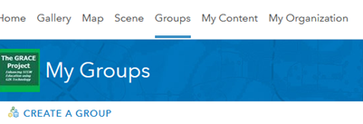

Log in to my AGOO and go to menu item Groups

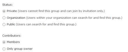

Click edit
Scroll down and select the radio buttons Private under Status and Members under Contributors
By selecting the status = private, only group members who sign into the AGOO  (my students and I)  will be able to see the content that is shared to this group.

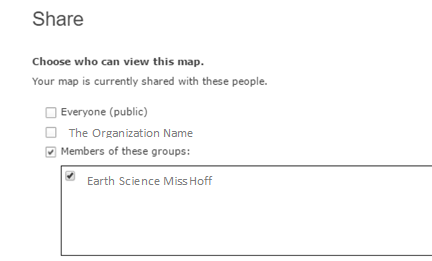

By selecting Contributors = Members (my students and I) can share maps, documents, images etc with this group. To share a map with this group the student (or I) selects the Share button. The Share button can be found in three places: the item Details Page,  the Map Viewer,  and My Contents.
When I click the share button a pop-up window appears with some check boxes. I place a check in the box next to “Members of these groups” and a check in the box next to the  group “Earth Science Miss Hoff”.
Only members that I have added to this group have a check box for the group  “Earth Science Miss Hoff”.  When I or a student make these two check-marks the item will be visible to the members of the group. (Note: If the other check boxes are checked as well the item becomes visible to people outside the group).
There are a couple of ways to make the group visible to the students. In this example I would tell my students to log in to the School AGOO and go to the menu item "Groups". Since they are group members the “Earth Science Miss Hoff”group will be visible to them there. They click on the group icon and then them shared items will appear!
