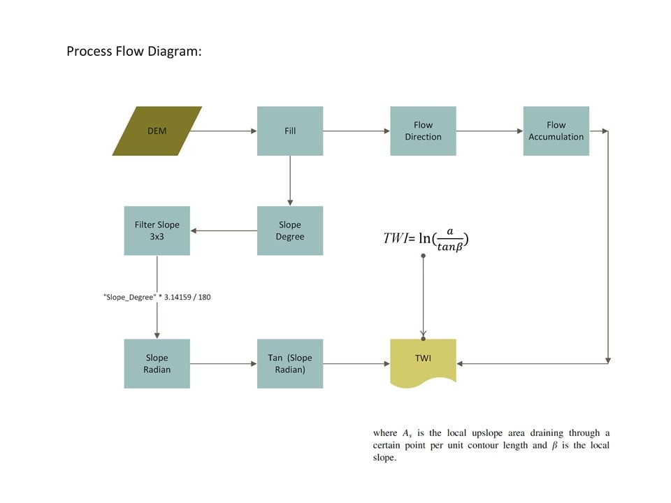

The below process diagram would acquaint you about steps I have taken to arrive at the positive integer values.

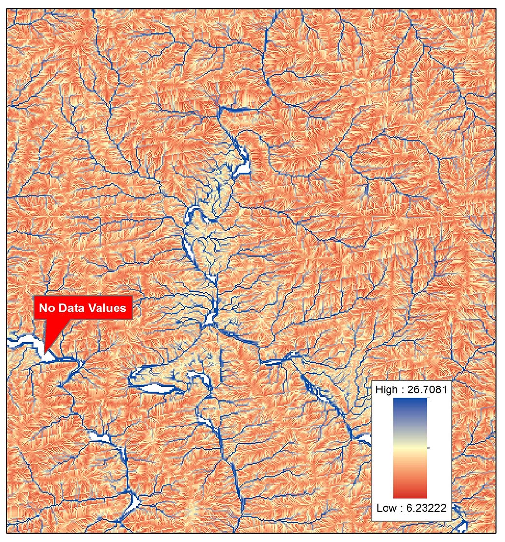

and the resultant image clearly indicates values having 'No Data'. These values are mainly confined to Zero Degree Slope within River.

Jayanta Poddar​, I am not interested to flag these pixels as No Data, I am intending to know why TWI raster results in 'No Data' Values over the surfaces where there is Slope Gradient equals to Zero?

Dan Patterson​, Yes, it assigns 'No Data' where it finds Zero Slope gradient.. On the contrary, these are the ideal places where water should be accumulated due to low gradient than those pixels surrounded by and also influenced by 'a', up slope catchment area.
In true essence,  Wetlands, ponds etc could be detected having analogues characteristics with respect to such slope gradient. But currently I am not aware for the remedial measures in order to eliminate such anomalies for the amicable results using TWI. As such “TWI calculates the capacity of water accumulation of each pixel in a watershed using a DEM” (Beven & Kirkby,1979).
The presence of No Data pixels (which are surely having Zero Degree Slope values) right in center of the river doesn't make sense to me.

Dan Patterson I have resolved this problem by modifying above expression;
Ln(("Flow_acc"+ 1 ) * 30/"Tan_SlopeRad")
Wherein, earlier I used Cell area 900(30x30)
There was nothing wrong with the Process Flow Diagram inserted above, however, I removed the 'Sinks' from the flow direction raster. Interestingly, it was earlier pre-processed and all depression were removed by 'Filling' these imperfections. However, now there are no anomalies in the derived raster and no cells contain 'No Data' values. I checked my results using WhiteBox with similiar algorithms used by ArcGIS (D8 method) and results were almost similar. Below is the results of TWI from ArcGIS , TWI.jpg
