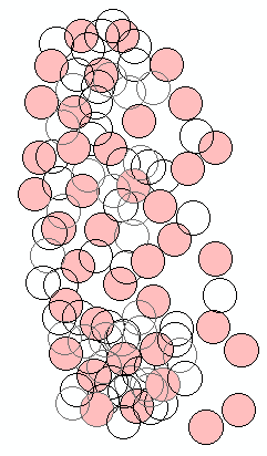

The following script iterates through your buffer geometries, and assigns each to a group where none of the geometries overlap. There are surely ways to streamline the code and this may not be very efficient for large datasets, so I make no guarantees there.
>>> def group_buffs(buff_dict, group_no): # the magic function
...     group_no += 1 # group ID
...     changes = 0 # see if any changes happened on this run
...     for k,v in buff_dict.iteritems(): # loop through buffer dictionary
...         if v[1] == 0: # if row doesn't have a group ID
...             test_geom = v[0] # record geometry
...             buff_dict[1] = group_no # assign group ID
...             break # just need the first one
...             if v[0].disjoint(test_geom): # if row is disjoint to the test_geom
...                 changes += 1 # record a change
...                 test_geom = test_geom.union(v[0]) # add current geometry to test_geom
...     if changes == 0: # no changes, must be done
...         return buff_dict # return the finished dictionary
...     else: # there were changes, call function again
...         return group_buffs(buff_dict,group_no) # call the function again and return the result
... buff_fc = 'buff2km' # the buffer feature class
... buff_dict = {} # an empty dictionary
... with arcpy.da.SearchCursor(buff_fc,['OID@','SHAPE@']) as cursor: # load OIDs and geometries to dictionary
...     for row in cursor:
...         buff_dict[row[0]] = [row[1],0] # key = OID, value = [geometry, default group ID]
... buff_dict = group_buffs(buff_dict, 0) # call function to assign group IDs
... group_field = 'group_no'
... #arcpy.AddField_management(buff_fc,group_field,"SHORT") # uncomment if need to add a field for group ID to feature class
... with arcpy.da.UpdateCursor(buff_fc,['OID@',group_field]) as uCursor: # update feature class with group IDs
...     for uRow in uCursor:
...         uRow[1] = buff_dict[uRow[0]][1]
...         uCursor.updateRow(uRow)
edit: I'll add that you can do exactly the same thing using PointGeometries and its distanceTo method, rather than Polygon's disjoint method.
CorrieNavis
Deactivated User
Ah, that output looks like exactly what I need (and your description of the script, as well)!! Unfortunately, I'm a total python novice (I've taken one GIS course and am using ArcGIS for my master's thesis project, but had no intro to python as part of that course)-- anyone know a good "python for dummies" thread?
