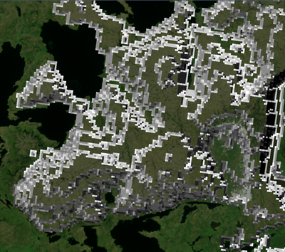

I have derived Topographic Wetness Index (TWI)/CTI with ArcGIS 10.3 using 30m DEM resolution. Earlier, it was propagating negative values which were mainly confined to ridges. I have restructured the 'Raster Calculator' expression as below and got rid of negative values.
Ln(("Flow_acc"+ 1 ) * 900/"Tan_SlopeRad")
The below process diagram would acquaint you about steps I have taken to arrive at the positive integer values.
and the resultant image clearly indicates values having 'No Data'. These values are mainly confined to Zero Degree Slope within River.

I am running into this same problem. I have tried your new formula but I still have so many areas with no data. This new version barely improved the original (multicolored).
My location is mossy, low lying tundra. A lot of the terrain is wet. But I want to use TWI to create a layer signifying the relationship between slope and wetness. The area that are missing would either be very wet (rivers and lakes) or dry (upland). But these values are missing.
