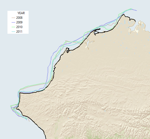

I have developed landfast sea ice extents that can be visualized as polygons, lines or rasters.  Now I need to calculate monthly and yearly averages and it is much more difficult to create an average line from a set of polylines than I had imagined.
I first tried to use raster world and the Euclidean Distance tools to determine the distance from shore, but since the ice lines and the shoreline are so complex I needed a way to measure the distance from the same point on land or the averages are meaningless.
so, I developed a set of tangent lines and intersected them with my ice edge lines to get a set of points.  I have been able to use spatial join to get the distances from shore and then add field and field calculator to get average distances along each of my tangent lines.
My plan is to then plot the average distances for each tangent line as a point and then connect the points to show the 'average' of my original ice edge lines for each month and year.
I think that I need to use linear referencing tools to get past this latest hurdle, so I created routes from my set of tangent lines.  Now I need to create points that are my 'average distance' from shore but I am at a loss.  I have minimal experience scripting and would appreciate help using the geoprocessing tools in modelbuilder.

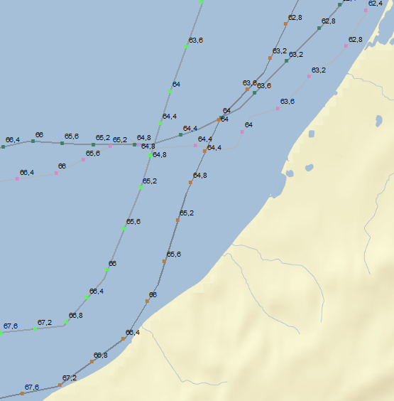

OK, I gave it a shot and this is what I got so far...
I took a random part of the globe:
... OK, I admit I georeferenced the image that was attached.
Digitized the coast line, and 4 ice edges (no to mucho detail) and started coding.
The process consists of the following steps:
  • get the coast line polyline
  • create a featureclass to store the routes (ice edges where each vertice has a m-value representing the relative position on the coast line)
  • loop through the ice edges and fill the m-enabled featureclass with the ice edge routes
  • create a table with events and fill with YEAR values and M values
  • execute MakeRouteEventLayer_lr to generate a layer with point events based on the ice edge routes and the event table
  • create a nested dictionary with the event points and relevant information
  • get min, max and mean statistics from the nested dictionary
  • ... generate polylines and write the resulting geometries and statistics to the output featureclass
Example area showing the ice edges with the event points created on the lines with the m value (the relative position on the coast line).
... and the resulting MIN, MAX and MEAN lines (comparing the event points on the ice edge lines based on the m-values and distance to the coast line) :

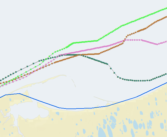

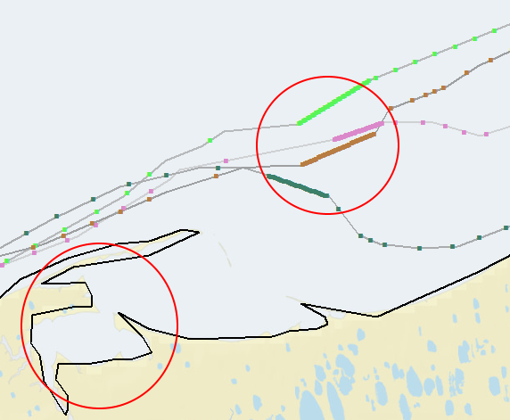

At second intent I simplified the cost line (less detail, since the more detail and strange forms it has, the bigger the effect on erroneous distribution of the events over the edge lines:
after the simplification of the coast line (with a higher step setting):

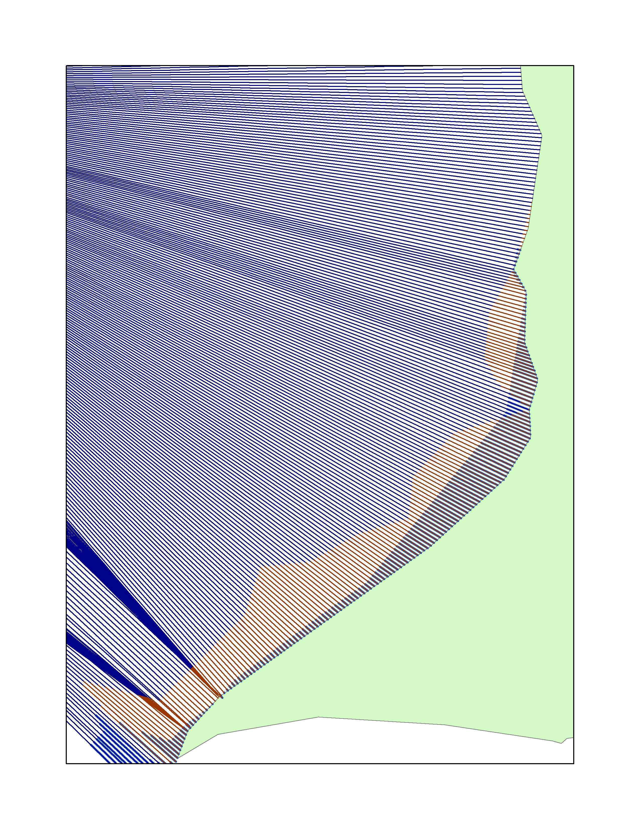

DanPatterson_Retired
MVP Emeritus
Now you did say you had lines radiating out to those lines... just a thought Splitting lines at a specified distance or percentage—Help | ArcGIS for Desktop
AarielRocha1
Deactivated User
Thanks for the response Dan.
I have already split my tangent lines at the intersections with each of my ice edge lines.  That is how I got the lengths (=distance from shore) for each date that I needed to get the average distances.
