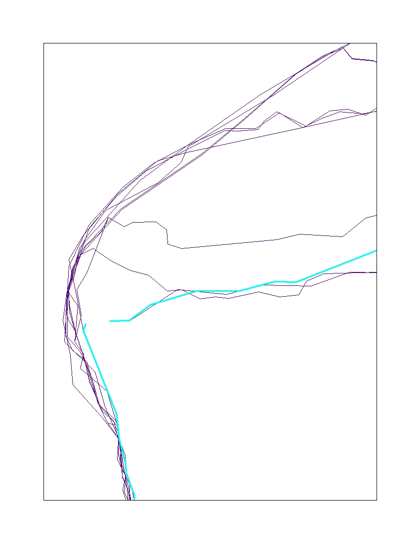

Thank you kindly for your support on this problem.  I have been able to apply the script properly, however when I modified the ice lines something strange happened.  It seems that when the routes are created there is a sort of 'doubling back' in a straight line that throws of the results.  Since the problem began when I modified length of the ice lines by clipping off the ends, I think it may have to do with the step setting?maxmin2.jpg
XanderBakker
Esri Esteemed Contributor
Hi Aariel Rocha , could you attach a sample of the modified ice line?
There could be several reasons for this behavior. Are the features still single part? If not this could be a reason since maybe the parts have different directions (some pointing north some south).
Another reason may be that there may be several features that have the same "YEAR"value. It is supposed that the field contains unique values (one feature per year). If this is not the case, you may need to dissolve the lines by YEAR and use the unsplit option and check if the features are created correctly (single parts).
AarielRocha1
Deactivated User
Xander,
Each of my ice lines is single part, and all year values are unique.  However, looking closely at my lines, I see that the offending ones have breaks in them Untitled.jpg(and thus may behave as a multipart, I suppose).  I will fix those and try again.
Thank you very much for your quick response.  Your assistance has been instrumental in my progress and is much appreciated.
Aariel
AarielRocha1
Deactivated User
That was it!  I had clipped my ice edges to an outline of my study site and discovered some topology issues between the coastline and the ice-free areas of the coast.  When I preformed the clip, some of the ice edges became fragmented and that threw off the results.

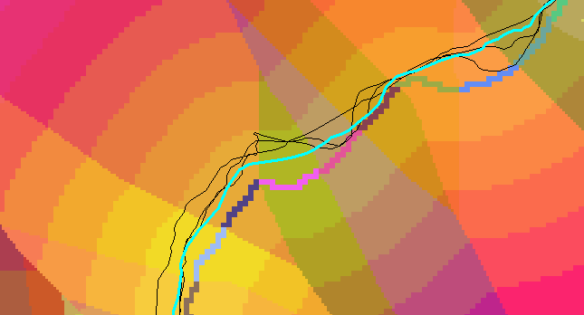

I though this was an interesting problem, and, waffle-head that I am, went at it with an entirely raster approach.
  1. This conveniently avoids issues of topology!
  2. There's a lot of variability in these ice extent lines so I took the approach of averaging distances for equal length reaches of coastline, instead of thousands of tangent lines. You could simplify the coastline just for the allocation processing to straighten it enough to allow more bands if you wanted to split the coastline more.
I think this is a neat example of a problem that can be expressed and solved very simply using map algebra.  That said, I am in awe of Xander's code up-thread. Xander probably provided a more accurate solution than this raster approach, pretty as it is.
from arcpy.sa import *
env.extent = "coast_simple"
env.cellSize = 10000
# create a raster of coastline cells
arcpy.PolylineToRaster_conversion("coast_simple", "OBJECTID", "ccell")
# Create coastline cell zones
# find the southernmost cell (this approach would vary with coastline config)
arcpy.RasterToPoint_conversion("ccell", "ccellpt")
arcpy.AddXY_management("ccellpt")
where = "ABS(POINT_Y - {}) < .001".format(arcpy.Describe("ccellpt").extent.YMin)
arcpy.MakeFeatureLayer_management("ccellpt", "cmin", where)
# Create 20 equal-length reaches along coast line
cc = ExtractByMask(CostDistance("cmin", Con(IsNull("ccell"), 1e6, 1)), "ccell")
cc1 = Slice(cc, 20, "EQUAL_AREA")
# separate ocean into areas corresponding to each coastline reach
calloc = EucAllocation(cc1)
# calculate distance from (any) coastline
cdist = EucDistance(cc1)
# get statistics for ice lines along coast for each year
for year in [2008, 2009, 2010, 2011]:
    arcpy.SelectLayerByAttribute_management("ice_edges", "", "YEAR = {}".format(year))
    ZonalStatisticsAsTable(ExtractByMask(calloc, "ice_edges"), "VALUE", cdist, "stats_{}".format(year), "DATA")
