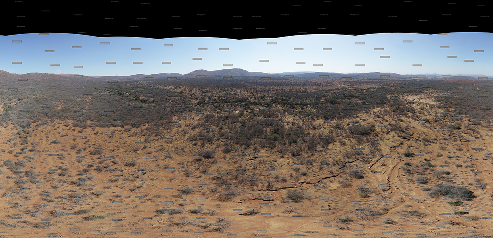

I thought I would provide some feedback - I have a workable solution!  So I tried PTGui but the free version really has excessive watermarks, rendering it just about unusable.   I share below a screengrab to demonstrate what I mean.
I tried a few other free options but really liked Microsoft's Image Composite Editor although I understand it is no longer supported  - but I was able to find the install file on the Internet.
Equally important is sharing 360 pictures and I found kuula.co a be a great free option. It can handle quite large files (larger than some of the other options I tested), but when exporting images from the stitching software, I had to make sure that I set the maximum width to 16384px and then it loads and displays perfectly.

@MervynLotter, ah well it seems PTGui has gone downhill since I last used it 😕
However, I can help with the options for displaying online, and Momento360 is pretty awesome. It's free, you can embed into your website,  and you can link it to a VR headset.
https://www.momento360.com/
