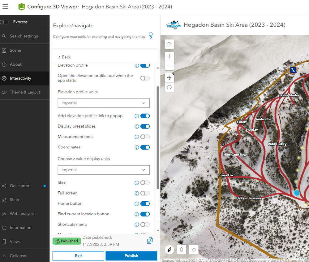

I tested with this app on both desktop and mobile and both rendered with the units I configured when creating the app.  During the app creation/configuration experience did you set units when enabling the elevation profile tool?

BrettGovernanti1
Thanks for looking. Yes, I set those values during app creation, that's why this has me confused. It shows feet on my desktop computer in elevation profile but it shows meters on mobile devices phone and tablet. I even tried a different browser on my phone and same result. Weird huh?

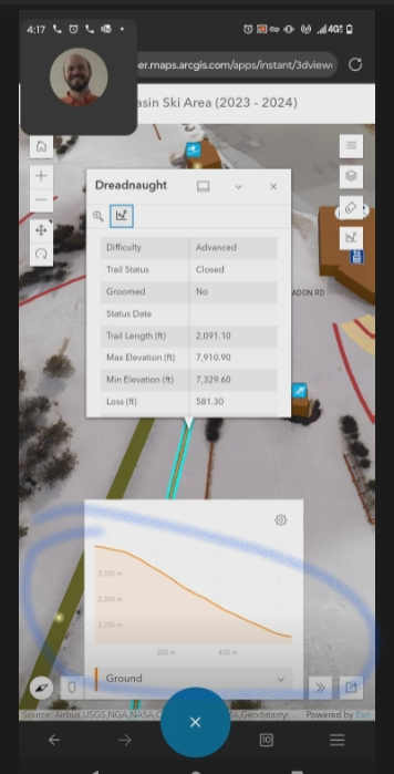

BrettGovernanti1
And here is my mobile screen for the same app, showing Meters in the Elevation Profile for the selected trail, circled in blue. The resolution isn't great on the screen capture so you may have to zoom in to see the units.
