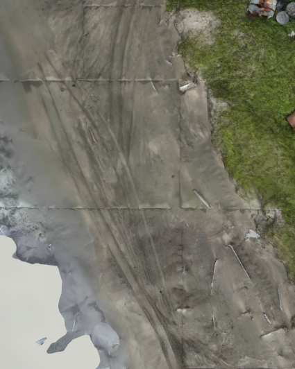

In the last two weeks, artifacts have appeared in imagery (see below) when I view it in scene viewer. This doesn't happen when I open the same data as a scene layer package in ArcGIS Pro. Has anyone else had this same issue?

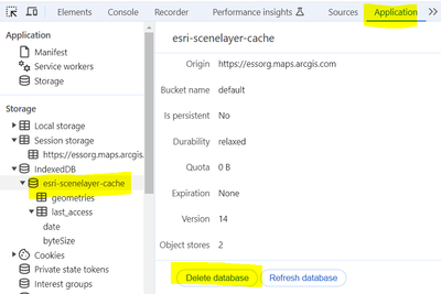

We identified the problem of the broken drawing shown in the screenshot (the funky colorful triangles) when applying &disableFeatures=im-shading
  • SceneLayers (which includes Integrated Mesh Layer) are cached in the browser's indexedDB for performance reasons
  • a slightly different version of  integrated mesh data gets cached when the url parameter  &disableFeatures=im-shading is set
  • loading a non-matching version from the indexedDB cache causes the broken rendering
The fix/workaround: when switching between im-shading disabled and enabled using the url parameter, the browser's indexedDB cache must manually be deleted
Clear SceneLayer indexedDB in Chrome (similar in other browsers):
  • open developer tools
  • navigate to Application tab
  • under Storage / IndexedDB, select esri-scenelayer-cache
  • click Delete database
Apologies for the inconvenience on this, we hope this workaround is sufficient for you for the moment.

With the 4.30 release, we "Added shading to IntegratedMesh3DTilesLayer and IntegratedMeshLayer"
 (https://developers.arcgis.com/javascript/latest/release-notes/#bug-fixes-and-enhancements).
In case your imagery is an integrated mesh this likely explains the visual difference.
In this context, surface normals (the local direction of the surface) on integrated mesh are used to shade (apply lighting to) the surface. This helps to improve realism under specific lighting conditions and integrate IntegratedMesh data better into the scene (since most scene elements are being shaded this way). Shading also helps to understand the shape of the integrated mesh better, but at the same time might expose issues in the data set. In the case at hand it seems that the data has incorrect normals at tile borders (normals not properly interpolated across borders), which get more visible now due to shading.
