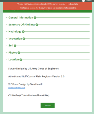

I tried to go through the form, and I got the error message shown below.  I want to pass it on to our wetlands specialists to see what they think of it, since their feedback will ultimately be more helpful than mine.
I'd be interested to see what the data output looks like though since at this moment they are pretty comfortable filling in the Excel form this project is sourced from.  I want to try to combine that step though since they seem to double their effort by filling this form out twice.
ThomasHamill
@RobertVerheggen1, I just reconfigured access, so try again with a submission.

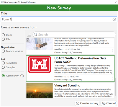

Update: An XLSForm design for the USACE Wetland Determination Data Form (Atlantic and Gulf Coastal Plain Region) has been accepted by the Esri Survey123 team and published as a community template in Survey123 Connect. Search for "USACE" in the New Survey menu of Survey123 Connect with the "Community" button selected to locate the template.
Kindest Regards,
t
ThomasHamill
Update:  The USACE Wetland Determination Data Form (AGCP) is now available in the Community section of Survey123 Connect.  Here's the direct link to the survey item.
