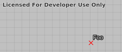

So a coworker gave me a kml file to display in my disconnected system and that kml file refers to symbols from web icons.
So I modified the sample from https://github.com/Esri/arcgis-runtime-samples-qt/tree/main/ArcGISRuntimeSDKQt_CppSamples/Layers/Dis... and put the kml as the local file to load.
In my disconnected system the icon does not end up being correct, just a red X.  I know that the symbols used will be fairly limited and I should be able to pre-cache them somewhere in my system.
Is there a way to have some sort of configuration mapping saying that if it is looking for a certain weburl to actually load a certain local file?
This is on Runtime Qt 100.14,
sample picture:
simplified kml snippet:

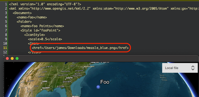

Hi @TroyFoster. First, sorry for the delay in getting back to you. We've been busy preparing our first Qt 6 release, which is coming very soon.
I looked at your code and situation, and I don't know if there is any way to map those online urls to a local cache. However, I did find that with 100.14 I was able to load them up on my mac with local paths once I downloaded the files.
See below.
Let me know if that works for you.
TroyFoster
Adding more onto this, when I traverse the kml nodes, the "foo Points" folder node, its style ends up being a nullptr when the kml is loaded.  When I traverse to the placemark node I can see that for the placemark the style is iconStyle but changing the url for the icon does not seem to affect the drawing of the symbol.
