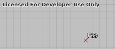

So a coworker gave me a kml file to display in my disconnected system and that kml file refers to symbols from web icons.
So I modified the sample from https://github.com/Esri/arcgis-runtime-samples-qt/tree/main/ArcGISRuntimeSDKQt_CppSamples/Layers/Dis... and put the kml as the local file to load.
In my disconnected system the icon does not end up being correct, just a red X.  I know that the symbols used will be fairly limited and I should be able to pre-cache them somewhere in my system.
Is there a way to have some sort of configuration mapping saying that if it is looking for a certain weburl to actually load a certain local file?
This is on Runtime Qt 100.14,
sample picture:
simplified kml snippet:

Adding more onto this, when I traverse the kml nodes, the "foo Points" folder node, its style ends up being a nullptr when the kml is loaded.  When I traverse to the placemark node I can see that for the placemark the style is iconStyle but changing the url for the icon does not seem to affect the drawing of the symbol.
