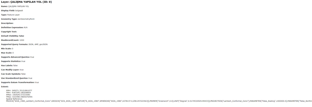

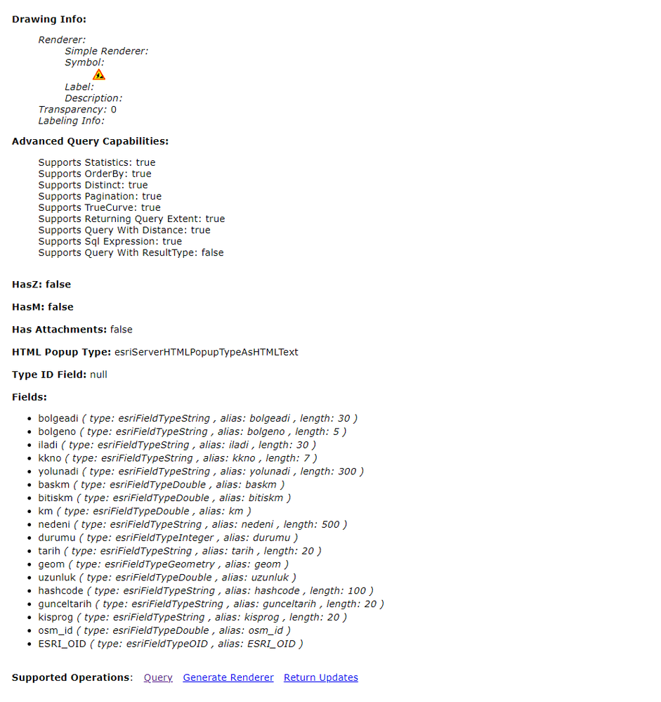

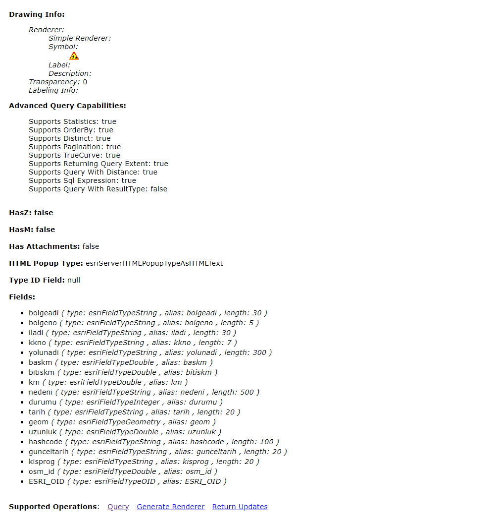

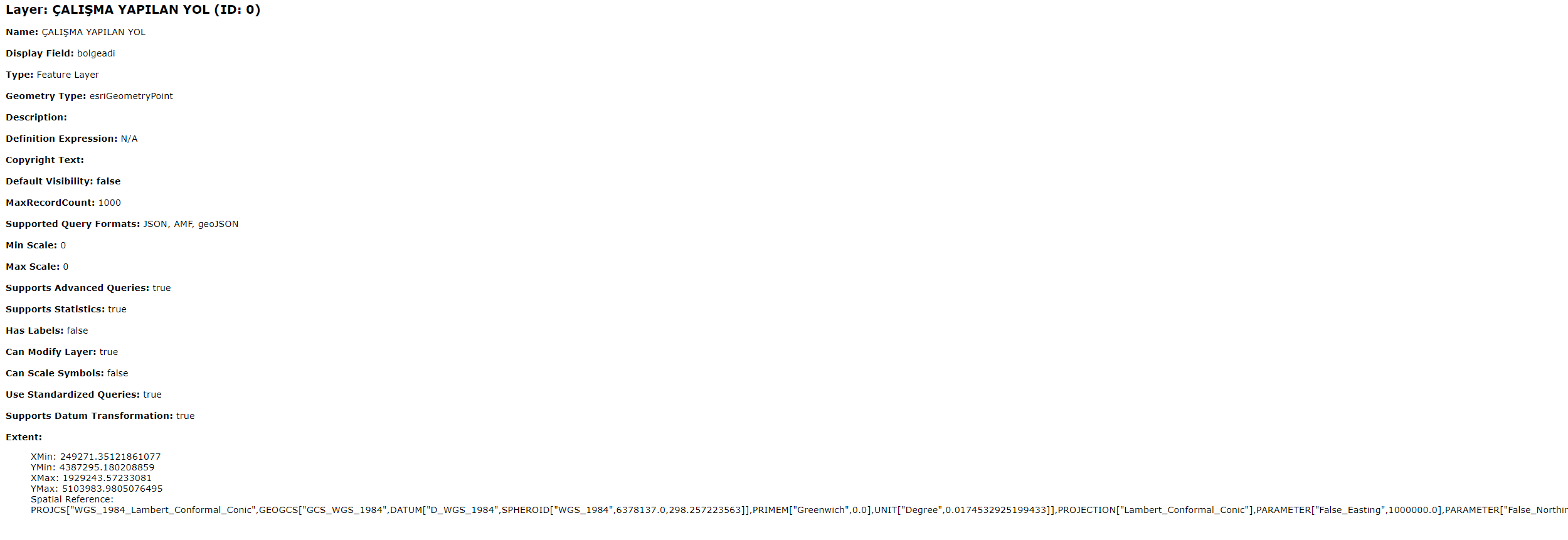

The content of one of the FeatureServices used is below as an image:
