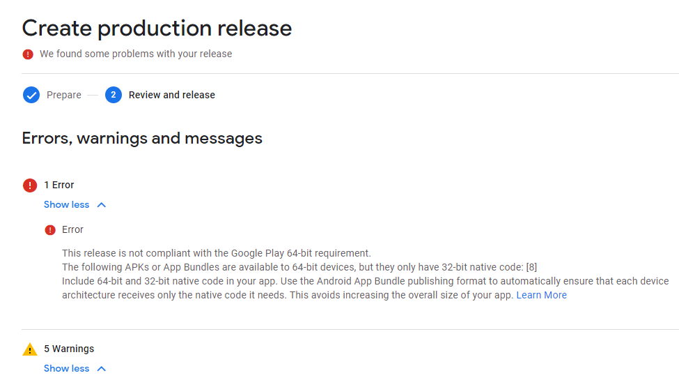

I using ArcGIS_Runtime_SDK_Qt_Windows_100_14_01 sdk. Im using Qt Creator 7.0.2 Based on Qt 6.2.3 (MSVC 2019, 64 bit) and Kits Qt 5.15.2 (Android Clang Multi -Abi and MinGW 64-bit ) . I am uploading the new qt application (.aab file) to an old android application to google play console as an update.I get the error in the image below in the review and publish section:
Here is also more detail link below for google play:
Learn More

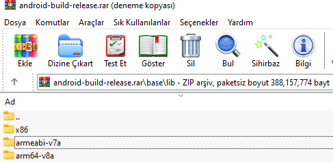

Also, I opened my .aab file as .rar file in the lib folder  3 architectures  includes as in the picture below:
Probably needed ArcGIS libraries for architectures other than armeabi-v7a.For example like compiling ArcGIS in 64 bit (arm64-v8a) . If this is the problem how to do this compilation in version 5.15.2 ? Can you help?

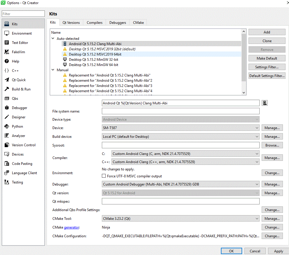

Here is my Android kit detay below:

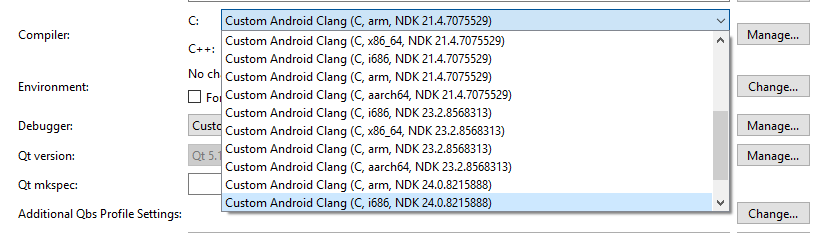

Here is also C compiler options from Combobox are also below:

When the build process is completed, there is an x86 folder in the base\lib folder in .aab  as seen below:
If we are not going to use x86 architecture in solving the problem, how can we prevent it from coming automatically?To fix the problem, should the x86 folder not appear here?

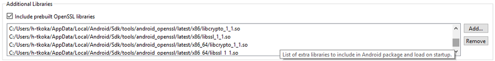

In addition, there are x86 files in the "Include prebuild OpenSSL libraries" section in the Add-on libraries section.Will x86 ones be deleted?
