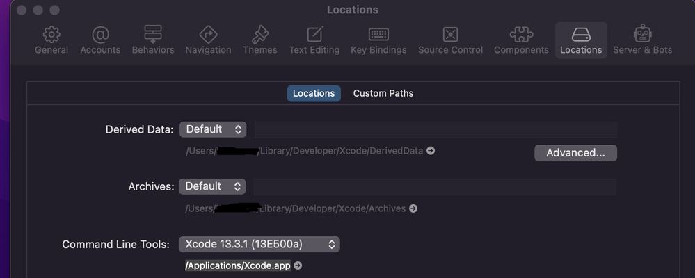

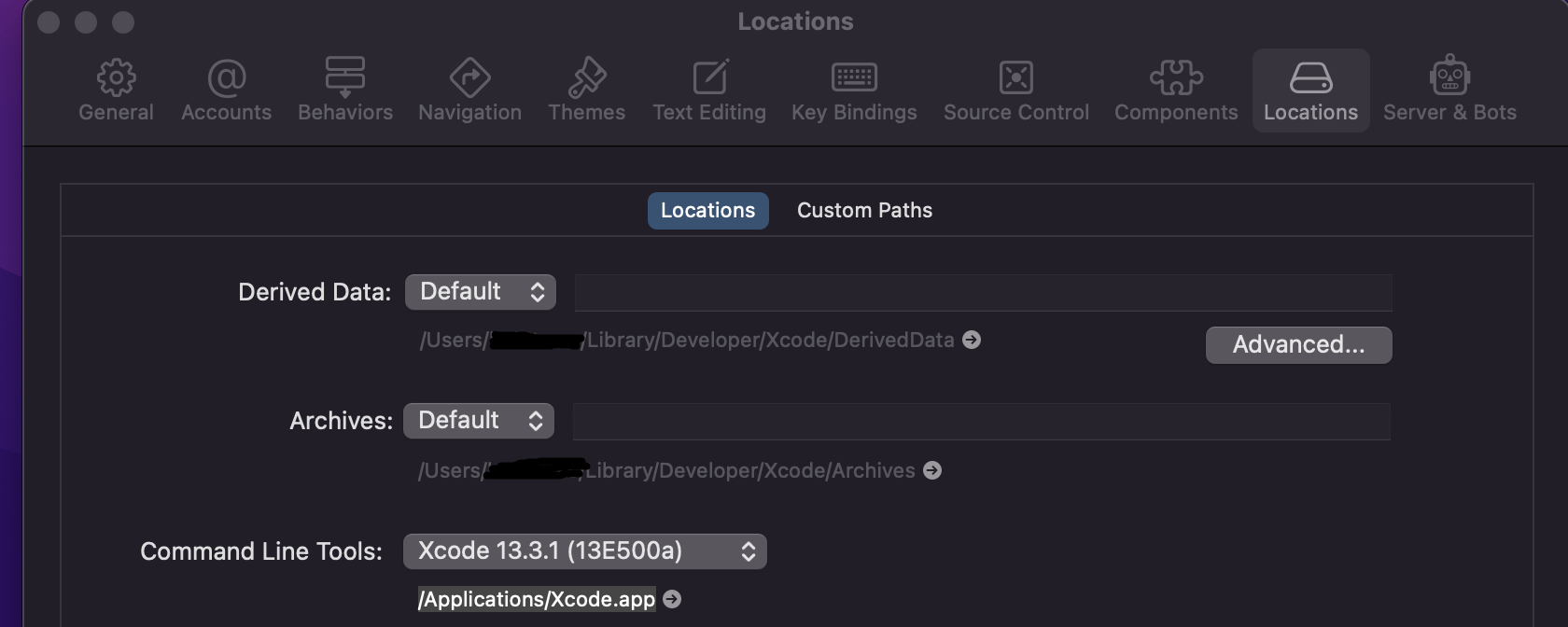

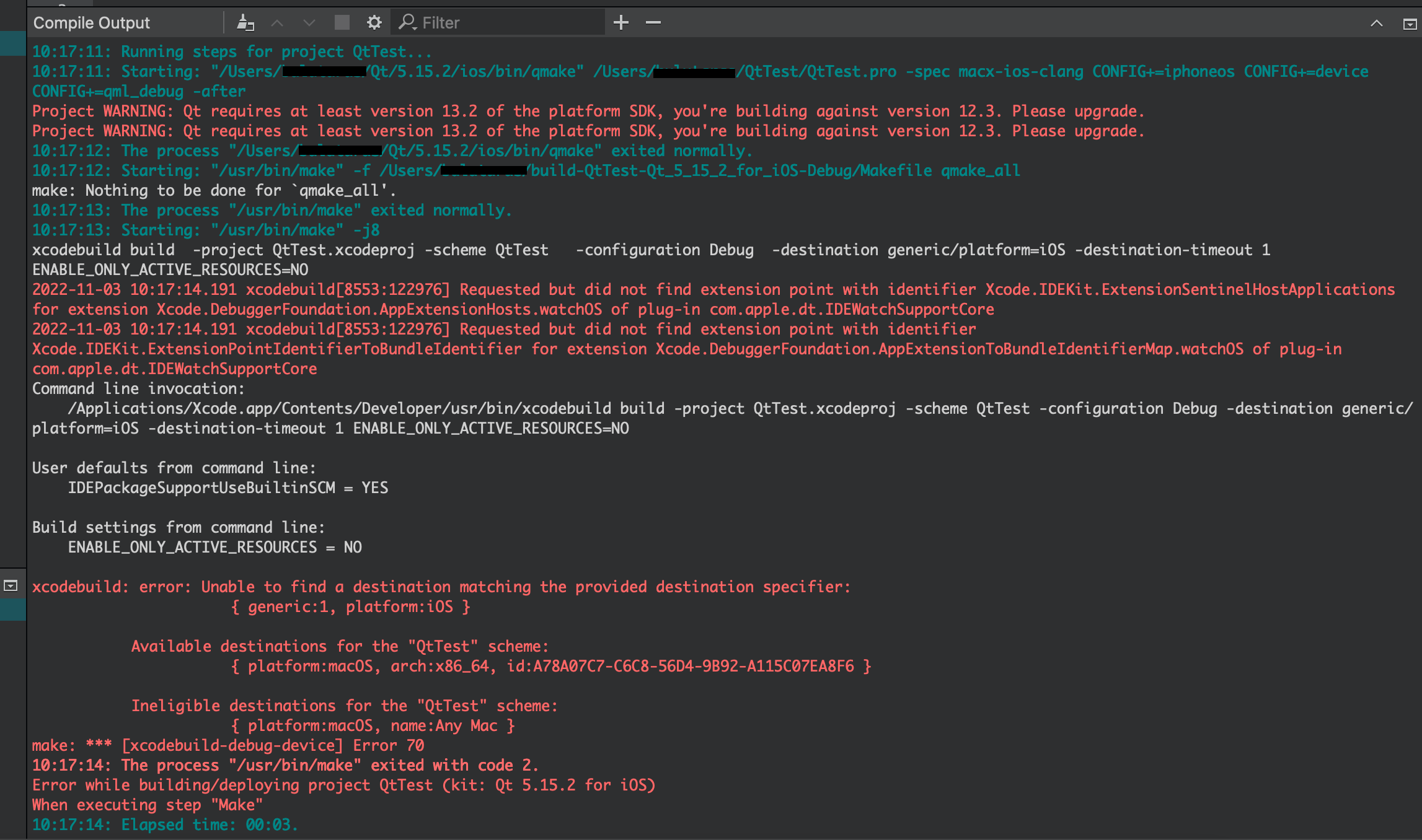

I want to develop a Map ( using Arcgis Runtime sdk for QT ) application in Qt (5.15.2 for iOS) for iOS devices on a MacBook computer, but before I move on to it, I get an error to compile a simple application. How can I  fix it?
Error , Compile Output picture and Xcode command Line tools version is as follows:

@AlessioWilliamsGava no,  for all ios versions supported in the App Store.My current Xcode version now is 13.3.1. Will it be solved if I install Xcode 14.1 version?  Because it seems that the xcode 13 version is sufficient for QT 5.15 as in the link: QT 5.15 for ios

Firstly I will trying to build with the ArcGIS Runtime SDK for Qt, but I haven't gotten to that stage yet, first of all, I couldn't compile a simple qt application ( 5.15.2 for iOS).
I update my code to Xcode 14.1 version. After that I run sudo xcode-select --switch /Applications/xcode_14_0_1.app/Contents/Developer line in terminal.

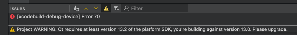

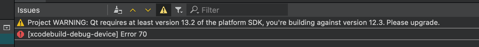

As a result, the error did not change but the warning changed as picture below:

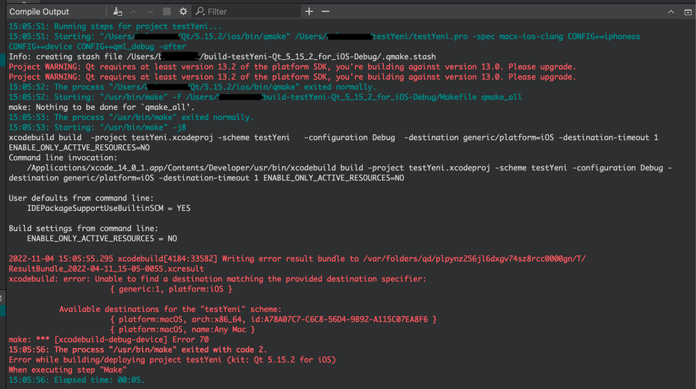

Qt compile output section:

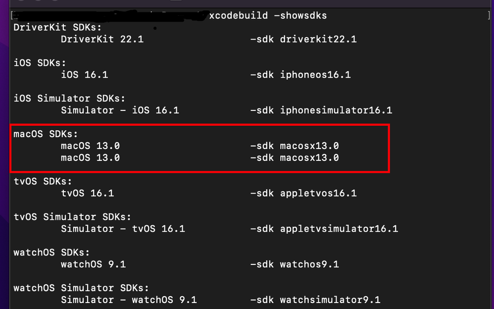

xcodebuild -showsdks picure:
Qt kits paths:
I installed the highest version of XCode (14.1). Do I need to install anything else? How should I solve the problem?

That being said, it looks like you're still building against 13.0 when you need at least 13.2. Make sure your device and your mac are up to date and you have platform SDK 13.2.
If you're confident you're building for SDK 13.2 or above, I saw something in my searches about deleting your shadowbuild folder and running it again. That might resolve the issue, but I can't be sure.
