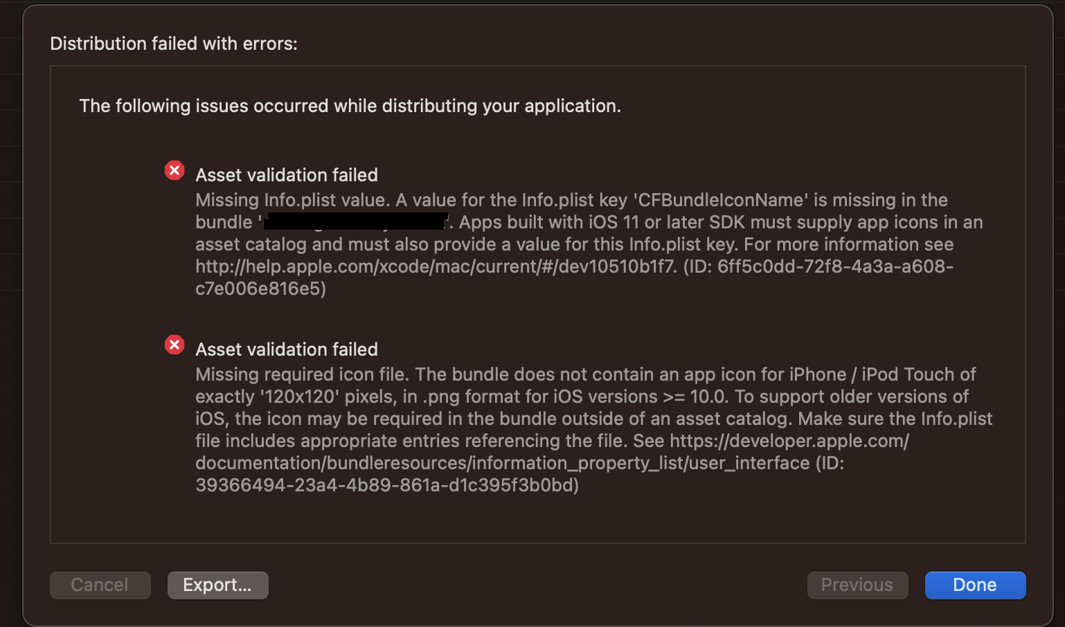

I developed a Routing Map ( using Arcgis Runtime sdk for QT ) application in Qt (5.15.2 for iOS) for iOS devices on a MacBook computer. I am getting an error while uploading the Qt application after product with archive in Xcode to Apple Sore.

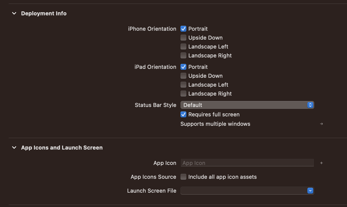

I don't have any problems with the Xcode 14.1 (Code Signing Identity : Apple Distribution : My Development Team, Code Signing Style : Manual, Provisioning profile : Compatible with the team) part, but can you help me solve the error that I think is related to the Qt application icons or icons files?
If this doesn't solve the problem, the app won't be uploaded to the app store, can you help?
Here is error picure below:
 XCode Deployment Infor and  App Icons and Launch Screen picture below:

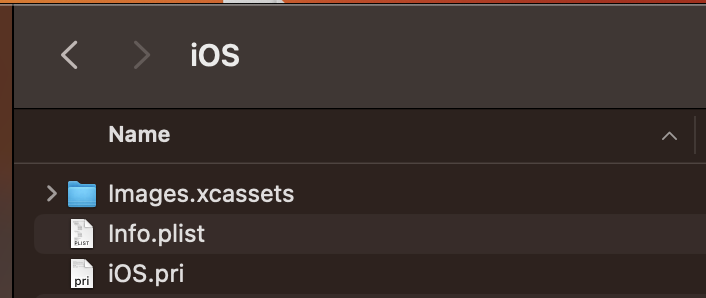

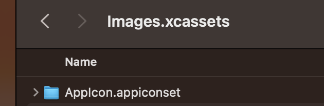

Here is also QT  İOS folder structure and files :

Hi @tanerkoka this doesn't seem like an issue related to the ArcGIS Runtime SDK and your question would probably be better answered on the Qt Forums.
That being said, it looks like you need a `CFBundleIconName` key in your Info.plist file and one of your iOS icons needs to be 120x120 pixels.

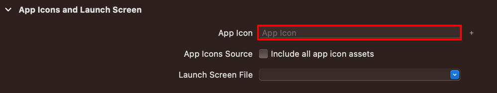

Do we need to write "AppIcon" in the red square in the Picture below?
