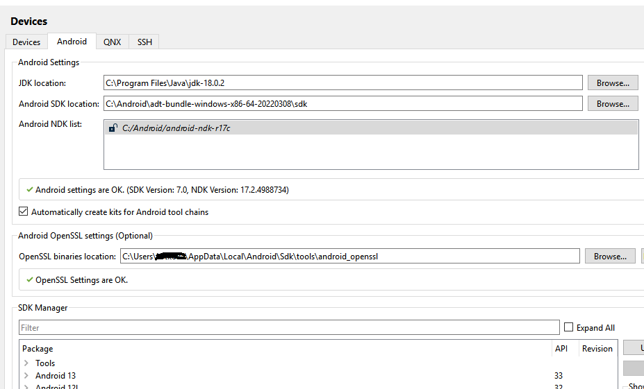

I want to run android  application with simple map using ArcGIS_Runtime_SDK_Qt_Windows_100_14_0 sdk. Im  using Qt Creator 7.0.2 Based on Qt 6.2.3 (MSVC 2019, 64 bit)  and Kits Qt 5.15.2   (Android  Clang Multi -Abi and  MinGW 64-bit ) . I installed the sdk from android studio. I use ndk separately from android studio (r17c) and last version of jdk-18.0.2.
When I create new simple project ArcGIS Runtime 100.14 Qt Quick QML app after nunning the project from Emulator. An error is received as below.
:-1: error: [C:\Users\h\Documents\build-map_4-Android_Qt_5_15_2_Clang_Multi_Abi-Release\android-build\libs/libs/RuntimeIndoors.jar] Error 1

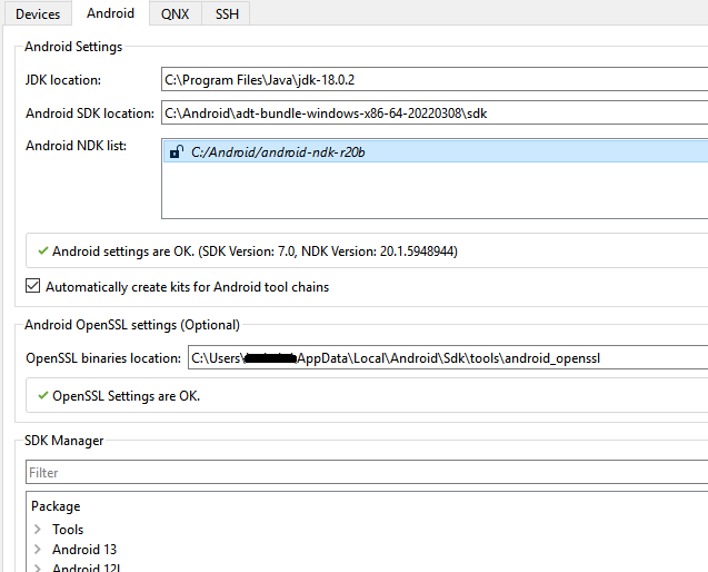

How can I solve this  problem or  Is there a mistake in the sdk I use or. If , yes , which sdks are needed to use 100_14_0 sdk.
Here is a Tools and Android options pictures below.

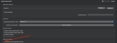

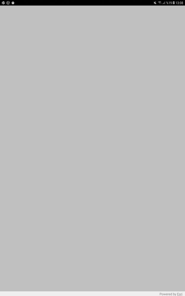

@tanerkoka you're nearly there! When you get the gray or white screen on Android, most of the time it is either missing SSL or an API key. I'd need to see your application output to know which one it is, but for now try to add SSL. You can do that in the project settings, seen here.

Thank you for helping for Android part  JamesBallard1

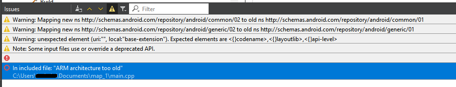

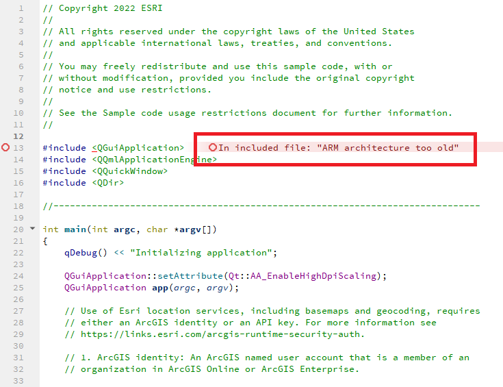

Android problem was solved. Not being apiKey is causing problem .But the  problem continues with Desktop Qt 5.15.2 MinGW 64-bit.
Here is ıssues below picture.

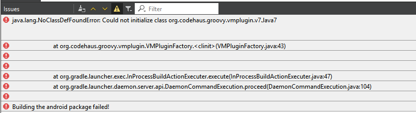

I tried to build with version 100.14.1, but during the build I got the following error. Can you help me? It will be an important step for me. Thank you.
java.lang.NoClassDefFoundError: Could not initialize class org.codehaus.groovy.vmplugin.v7.Java7

Caused by: java.lang.ExceptionInInitializerError: Exception org.codehaus.groovy.GroovyBugError [in thread "Daemon worker"]
at org.codehaus.groovy.vmplugin.v7.Java7.<clinit>(Java7.java:45)
at java.base/jdk.internal.misc.Unsafe.ensureClassInitialized0(Native Method)
at java.base/jdk.internal.misc.Unsafe.ensureClassInitialized(Unsafe.java:1160)
at java.base/jdk.internal.reflect.MethodHandleAccessorFactory.ensureClassInitialized(MethodHandleAccessorFactory.java:300)
at java.base/jdk.internal.reflect.MethodHandleAccessorFactory.newConstructorAccessor(MethodHandleAccessorFactory.java:103)
at java.base/jdk.internal.reflect.ReflectionFactory.newConstructorAccessor(ReflectionFactory.java:236)
at java.base/java.lang.reflect.Constructor.acquireConstructorAccessor(Constructor.java:546)
at java.base/java.lang.reflect.Constructor.newInstanceWithCaller(Constructor.java:496)
at java.base/java.lang.reflect.ReflectAccess.newInstance(ReflectAccess.java:128)
at java.base/jdk.internal.reflect.ReflectionFactory.newInstance(ReflectionFactory.java:341)
at java.base/java.lang.Class.newInstance(Class.java:677)
at org.codehaus.groovy.vmplugin.VMPluginFactory.createPlugin(VMPluginFactory.java:57)
at org.codehaus.groovy.vmplugin.VMPluginFactory.<clinit>(VMPluginFactory.java:39)
... 129 more
FAILURE: Build failed with an exception.
* What went wrong:
Could not initialize class org.codehaus.groovy.reflection.ReflectionCache
> Exception java.lang.NoClassDefFoundError: Could not initialize class org.codehaus.groovy.vmplugin.v7.Java7 [in thread "Daemon worker"]
* Try:
Run with --stacktrace option to get the stack trace. Run with --info or --debug option to get more log output. Run with --scan to get full insights.
* Get more help at https://help.gradle.org
BUİLD FAILED in 4s
Building the android package failed!
-- For more information, run this command with --verbose.
14:25:04: The process "C:\Qt\5.15.2\android\bin\androiddeployqt.exe" exited with code 14.
Error while building/deploying project map (kit: Android Qt 5.15.2 Clang Multi-Abi)
When executing step "Build Android APK"
14:25:04: Elapsed time: 02:33.
Here is also errors picture below.
Here is also config Android options picture below.
JamesBallard1
@tanerkoka we've also hit issues like this, specifically with gradle. Qt/Qt Creator controls which version of gradle is used, and different versions can impact which version of Java you need.
One thing I noticed is that your NDK version specified doesn't meet our minimum requirement.
https://developers.arcgis.com/qt/reference/system-requirements/#deploying-apps-to-android
21b minimum
Other than that I would review the version of Java you're using. Review Qt's requirements here:
https://doc.qt.io/qt-5/android-getting-started.html
Note: If you are using the SDK Tools 26.x or below, the JDK 8 is required. Versions higher than 8 might cause issues for the Android SDK tools.
And:
Note:JDK 11 or earlier must be used when using Qt for Android.
Hopefully this will get you on the right track.
tanerkoka
Thank you for helping  HomeroOriaAguilera.
 As you said , I used jdk-11 as JDK  also I used ndk-r21e as NDK. Android package built successfully , .apk file is successfully istalled on the device , but it opens to an gray usage instead of the map 😞 . Can you help me again ?
Here is screen picture below.
Here is also issues picture and main.cpp file picture below.

JamesBallard1
tanerkoka
JamesBallard1
@tanerkoka we do not support the MinGW kit on Windows. You must use the Visual Studio 2019 kit with the Runtime SDK for Qt on Windows. This is the reason you are seeing these build errors.
tanerkoka
After uninstalling the MinGW kits, which one should I choose from the Maintenance Tool instead? I was in a following as in the picure MSVC 2019 select.Is there an example of how to do it?
JamesBallard1
It is the MSVC 2019 64-bit option.
