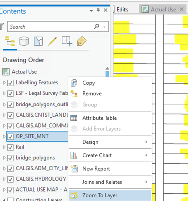

ChrisHolmes
Is it still the case that zoom to extent on the map view is not supported in arcpy? So far, my searching makes me think that it is not. thanks

Since 2018 when this thread was opened, ArcPy has added functionality.
aprx = arcpy.mp.ArcGISProject("CURRENT")
ext = # ArcPy Extent Object
aprx.activeView.camera.setExtent(ext)
The activeView property returns either the active map or active layout, and the camera can be accessed to set the extent.
ChrisHolmes
Yes, agreed. I was able to zoom to extents on the active view. But there's no way to do this on a map view that is not active or when working with a project that is not currently open in ArcGIS Pro.
thanks
ChrisHolmes
Having spent some time with the layout and mapframe I am now using zoom to extent and set scale on the map frame which works well.
Having said that the end use will still need to manually zoom to extent in the map view to do their work.
Ideally I would have liked to loop through all map views using arcpy and complete the zoom to extent before the aprx file opens so that all map views would be focused on the appropriate parcel when it opens, but this will have to do.
