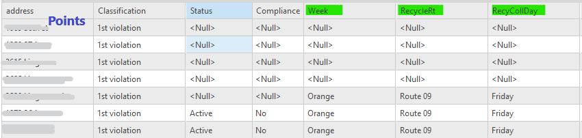

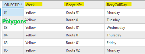

I have 2 feature classes events (points)  and districts (polygons). PolygonsPolygonsPointsPoints
I get new points every day and they need polygon (district) information.
I would like to copy over the fields Week, RecycleRt and RecyCollDay from the polygon feature class to the points.

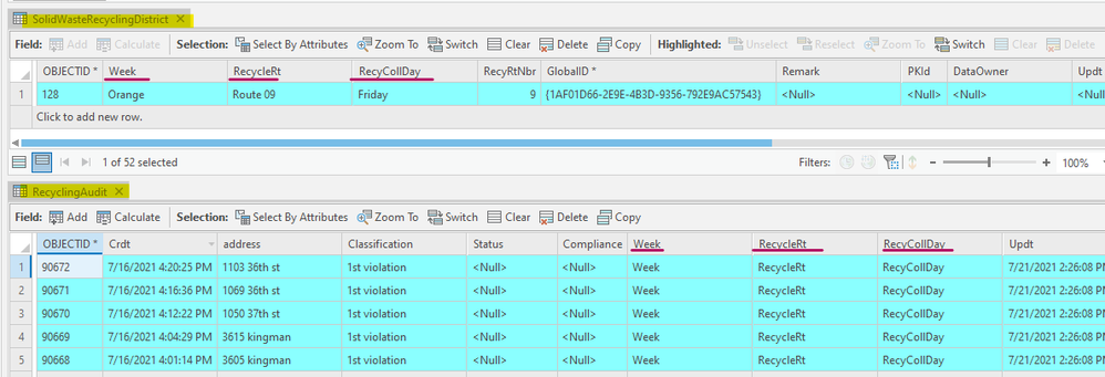

That fixed the error and the script works but not the way I was thinking 😅
Instead of updating the fields with the corresponding selected polygon's fields. It's just updating them with the words Week, RecycleRt and RecyCollDay 😣
