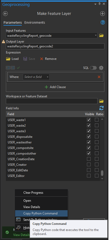

I find it useful sometimes to run the geoprocessing tool and then right click the green ribbon > Copy Python Command-- that is, if the tool runs successfully. Then copy that into your python editor. You can see how the  parameters should look.
