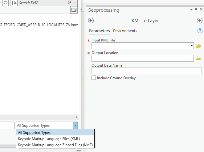

In my custom Python toolbox, I would like to create a similar input parameter as the "Input KML File" in the "KML To Layer" tool, i.e. allowing a layer to be selected by dropdown and by opening it from a file dialog (see screenshot below).

I am just wondering how Esri did it for the KML to layer tool though...

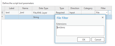

I'm not sure it's possible with a Python Toolbox, perhaps a bug report or an ArcGIS Pro Ideas feature request about supporting filters for composite datatypes (e.g. parameter.filters[n].list = ["kml", "kmz"]) like is possible for value table parameters.  In a PYT, a parameter with a composite datatype does have a .filters property, but all the elements (one for each datatype) are None, not a filter object).
It is possible using a script tool instead of a python toolbox though...
