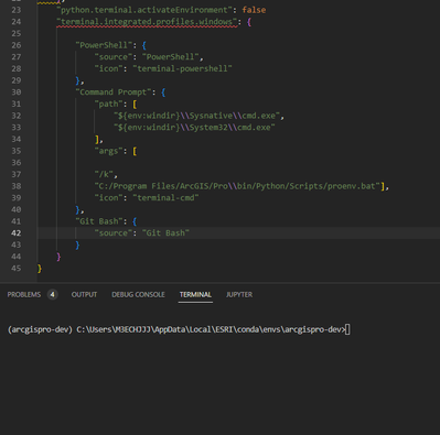

Then I made the settings change (in VS code, Terminal: Select Default Profile), setting the terminal to command prompt.
Everything runs smoothly now.
