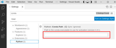

These are my VS Code settings I used (with cmd.exe as the default shell):
  "python.condaPath": "C:\\Users\\<myusername>\\Miniconda3\\Scripts\\conda.exe",
  "python.defaultInterpreterPath": "C:\\Program Files\\ArcGIS\\Pro\\bin\\Python\\envs\\<my cloned py3 dir>\\python.exe",
  "terminal.integrated.defaultProfile.windows": "Command Prompt",
  "terminal.integrated.profiles.windows": {
    "Command Prompt": {
      "path": [
        "${env:windir}\\Sysnative\\cmd.exe",
        "${env:windir}\\System32\\cmd.exe"
      "args": [""],
      "icon": "terminal-cmd"
