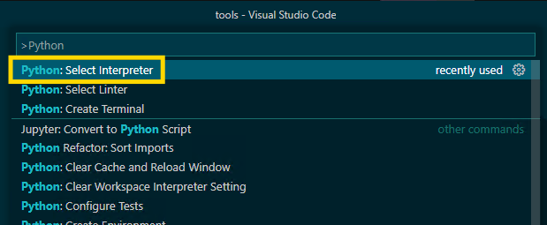

I first cloned a Python environment from the ArcGIS Pro Package Manager, and then set the location of the Python interpreter in VS Code to the "python.exe" in my cloned env (which for me, was in this folder: %LocalAppData%\ESRI\conda\envs\my-cloned-environment\python.exe).
select_interpreter
 And that was actually all I needed to do in order to run and debug a script. I am able to create a new Python debugging configuration in VS Code, set breakpoints step through the code, and get IntelliSense on all ArcPy modules & methods. However, there is still something I am not fully understanding, I think..

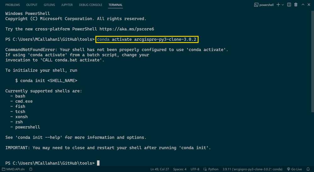

On VS Code Terminal launch, I get the following error:
not_activated

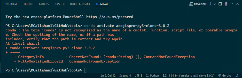

 That looks to me like the system PATH environment variable has not been configured for Conda, and Powershell does not recognize the conda command. The Conda docs actually recommend not modifying the PATH env var, but if I do, I can resolve the error above, and the conda command is recognized.
However, that yields another error, "CommandNotFoundError: Your shell has not been properly configured to use ‘conda activate’.”
working1-1

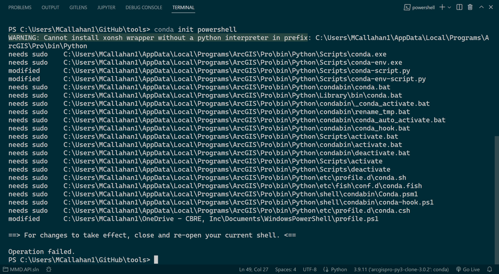

 Looking at the error message, I see that it is saying to run command conda init powershell, however, this also yields an error an I am stuck at this point, unsure how to proceed. Running VS Code as admin did not resolve the issue.
conda_2

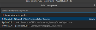

Now it shows me the list of Conda environments, which on my computer looks like this.
It found both my Esri environments and one(s) set up using "miniconda" which I have separately installed (you don't need miniconda) Note I installed "miniconda" because it works better for me from Bash shells so it finds that version of Python as well. (Having both the Esri conda and minconda installed works fine.)

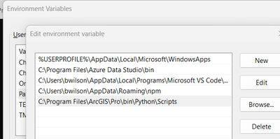

Next I add the Scripts folder to my environment PATH settings,

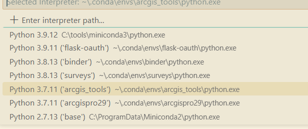

Does VSCODE see your conda environments? You should be able to see them if you do F1->Python: Select Interpreter
Mine look different probably because I have a separate install of Miniconda too.
