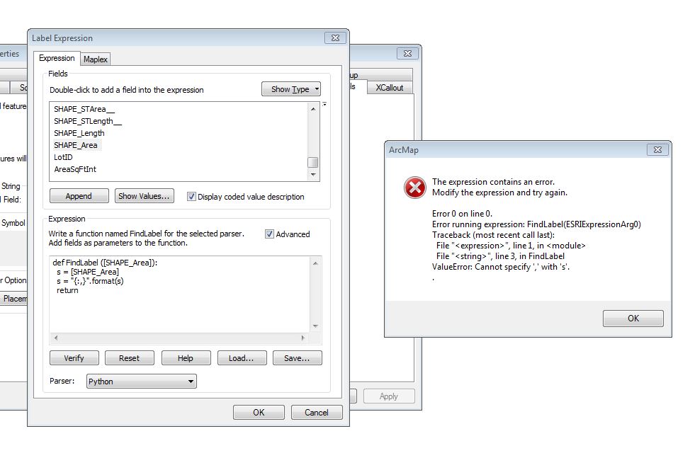

python parser.... then why are the fieldnames enclosed in square brackets instead of ! !  ?? Is this unique to labelling? Chris, I don't do much labelling, but did you pick the parser before building the expression or after?  and what's up with the one space indentation? does Arc* put that indentation in or is that you?
ChrisDonohue__GISP
MVP Alum
I was noticing that too.  It doesn't matter if the Parser in the Label Expression is changed to Python first or not, the field names come across with brackets when one double-clicks on the field you want to select it.  On top of that, if one changes the field name to be surrounded by exclamation marks instead of brackets(with Python still selected as the Parser) it errors out:
As for the one-space indentation, it is actually two spaces and that seems to be what ArcGIS defaults to.

so even str(!SHAPE_area!) errors out?  I am just wondering if the output is supposed to be string.
In any event, I don't do labelling, but I would be a tad peeved if Verify says nothing about what was wrong and more importantly, if the python parser is defective.  Good luck
