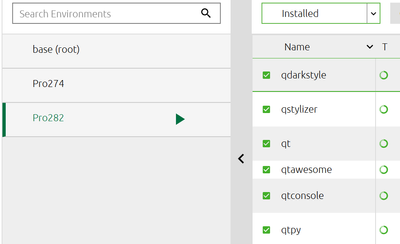

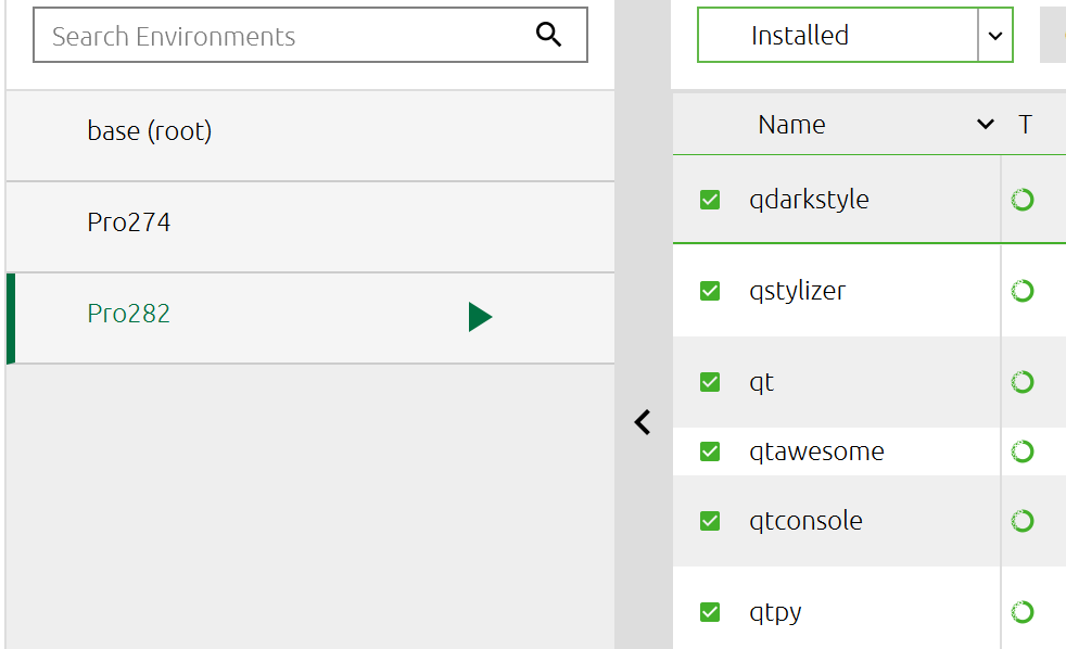

Not sure what the Qt mojo is about... When I do  'conda list' in the clone I see qt and qtpy:
Navigator sees them too:

I bet you didn't remove/rename the spyder folders in your c:\user\blah path prior to installing in your clone

Yeah... I don't know:  I wiped the 2.8.2 clone as well as a 2.7.4 clone (I clone to c:\clones), and then I ditched the navigator install for command line:
conda install spyder=5.0.5
And I'm up and running...
