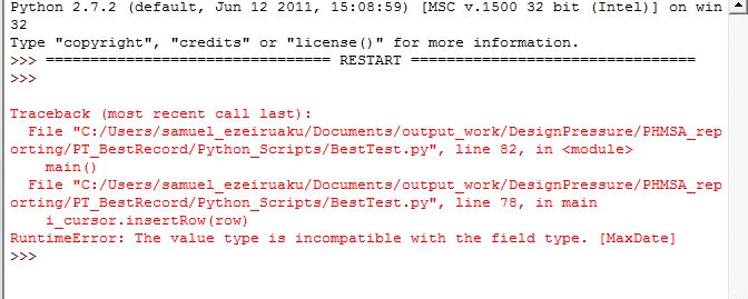

i think i know why the last script failed;
i noticed that from the segment, there are overlapping records for which one record/row do have a date and the other didn't... i think that was why we i had the error below(image)Capture.JPG...
ChukwuemekaEzeiruaku
Deactivated User
is there a line(syntax) i can add to it that'll which will add both the date and the null values for a segment?

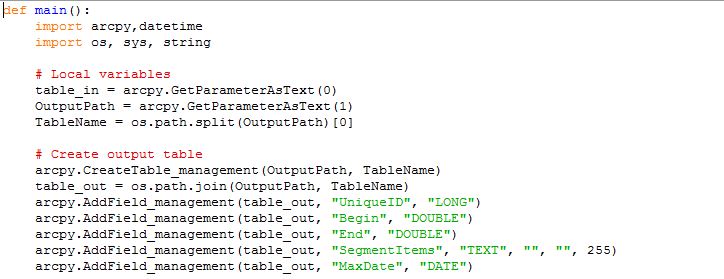

I'm trying to make a script tool for the script for just the input and output parameters and i  came up with:
After making the script tool i get the following error:
BlakeTerhune
MVP Alum
Looks like it can't find SegmentSequence_output12 in HT_Overlap_Inscope.gdb
Did you verify that feature class is there and that it doesn't have a lock?

Thanks for putting words out there for me not been able to view attachments,and i can now view attachments.
Oh it is supposed to create a GDB table from the user input from user input to also a user output as shown in the script (see picture above)
