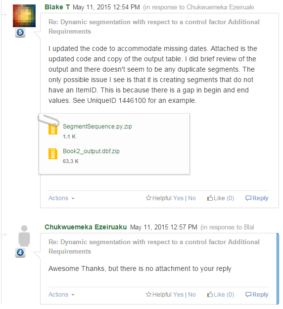

I updated the code to accommodate missing dates. Attached is the updated code and copy of the output table. I did brief review of the output and there doesn't seem to be any duplicate segments. The only possible issue I see is that it is creating segments that do not have an ItemID. This is because there is a gap in begin and end values. See UniqueID 1446100 for an example.

Awesome Thanks, but there is no attachment to your reply

You don't see this?

Nope, i can see just the text and not the attachments..
