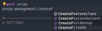

In VS Code, intellisense from base arcpy import:
also getting intellisense for management functions with this import style:
