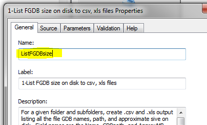

The tool name in the  pythonaddins.GPToolDialog line definitely shouldn't have spaces.  Make sure you are taking the Name and not the Label

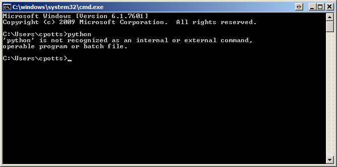

If you open a Command Prompt window (start, run, cmd) and type python and then import arcpy - do you get any errors?
CoyPotts1
Deactivated User
I got the following message.  If I open up Start > All Programs I have a Python 3.4 folder, and I also have Python27 and Python34 folders located on my C:, so I'm not really sure why it's not picking up Python.
IanBroad
Deactivated User

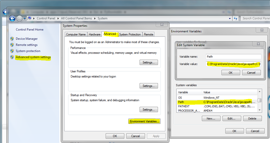

Yeah, I think your Windows Environment Variables are the issue here.
You need to right click on My Computer and go to Properties, then click on the Advanced system settings, and then on the Advanced tab click on the Environment Variables button at the bottom.
Next, in the lower part of the window find the Variable that says Path and double click on it, and makes sure that the following paths are at the front of the Variable value list:
C:\Python27\ArcGIS10.2;C:\Python27\ArcGIS10.2\Scripts;C:\Python27\ArcGIS10.2\Lib;
(Verify that these paths exist and are in this location, of course. If you just upgraded to 10.3 like you mentioned below, you'll probably need to change the paths to ArcGIS10.3 instead of 10.2)
You'll then most likely need to restart.
After restarting, try doing the python and import arcpy from the Command Prompt again.
