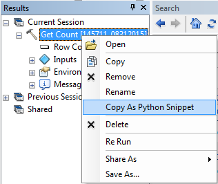

BlakeTerhune
MVP Alum
Try using ArcToolbox to run a simple tool (like Get Count). Was it successful? If so, open the Results Window, right click the tool result and copy the python snippet.
Paste the snippet code into your Python interpreter and run it. Does it error?
