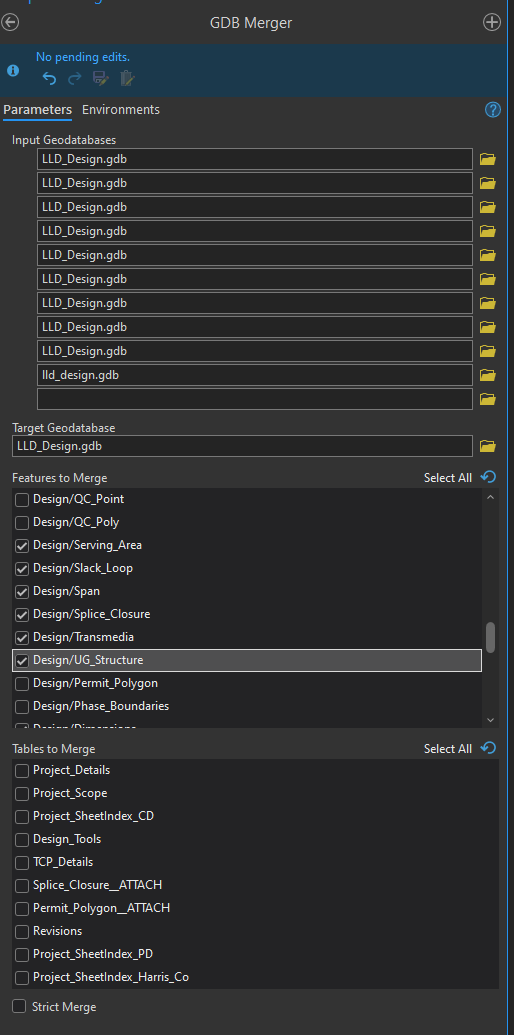

Interface Example

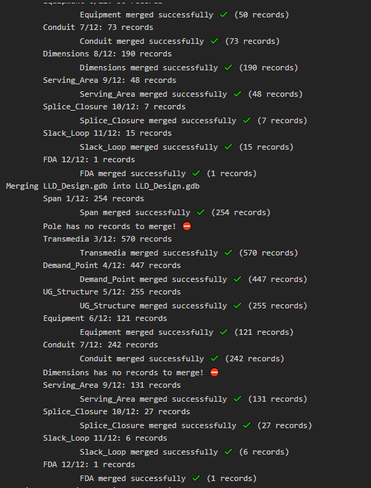

Messaging example
As you can see I was able to really simplify the actual meat of the tool. All the validation checks are handled by using overridden `| & ==` operators similar to python's internal set objects. This code will not work without the whole framework (available here as pytframe2) I've build some interfaces for FeatureClass and Workspace objects that allow a more natural interaction with them as objects in code and not a series of filepath strings that you move from function to function (see how the merge_table code is calling cursors on the objects themselves instead of on a filepath).
This technique is just a sideproject within the framework though. The goal of this framework is to make tool and toolboxes independent and allow for you to easily build helper modules in a maintainable way and get all the instant reload benefits of a flat PYT file.
