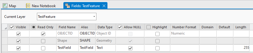

However, if I make any changes to layer Fields properties manually (by going to DataDesign -> Fields of TestFeature layer and making any changes and saving them) , FieldDescriptions are "fixed" and the result of above script is:
Number of fields: 3

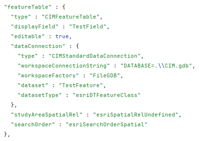

This behavior is also confirmed by analyzing saved layer files (lyrx, which in fact is JSON) before and after saving changes in DataDesign/Fields. Before saving JSON doesn't contain FieldDescriptions in CIMFeatureTable:

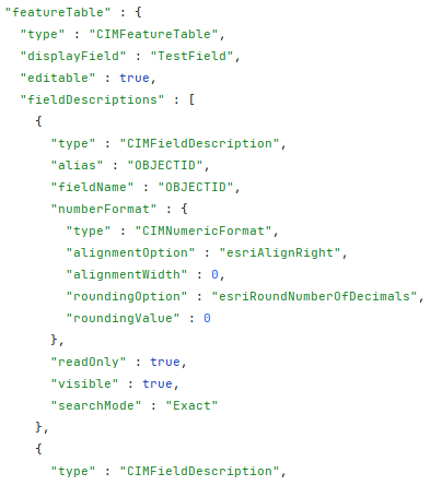

After saving (any, even not real) changes in Fields (making sure that Fields editor is started from Layer, not from Feature Class)
CIMFieldDescriptions appears in lyrx/JSON:
