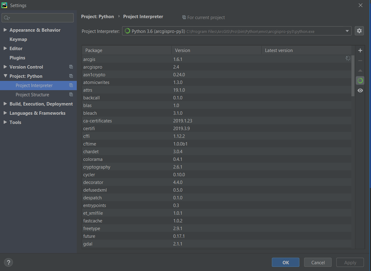

I can't tell if I am passing the SQL query incorrectly, writing the output file incorrectly, or if I have incorrectly pointed to the correct Python interpreter. However, the script works fine in Python Window and
This is my Pycharm interpreter, which I believe is pointing to the right spot:

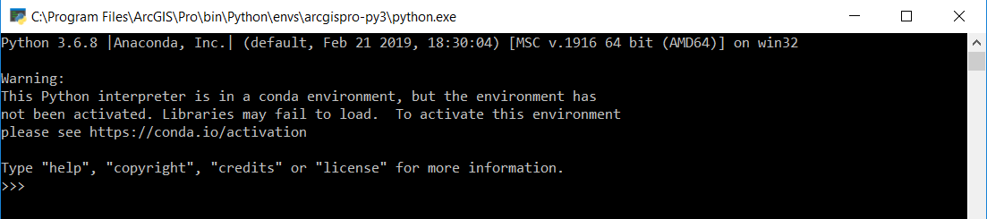

However, when I double click on the executable from explorer I get this:
Which seems weird to me but everything else seems to run fine.

Regarding:
when I double click on the executable from explorer ....
Don't.  The ArcGIS Pro installer creates a shortcut for properly activating the conda environment.  Running the Python executable the way you describe will eventually run into issues.
