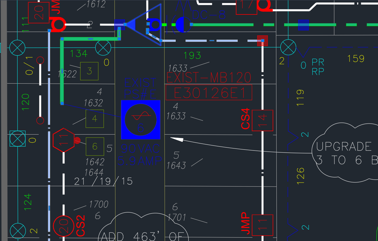

I am writing a script to convert CAD file into a format viewable in ArcGIS. I am using arcpy.CADToGeodatabase_conversion() for this purpose.
In my source CAD file, I have a variety of line types that are all different, like so:

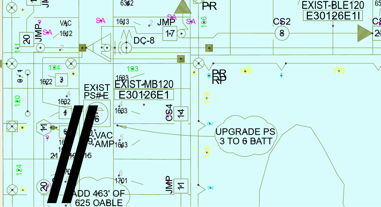

However, after running the function above and converting to a geodatabase, the same area has lines that are all homogenous:
Notice how the coloured and different shaped lines all have changed to be the same type of line in the ArcGIS feature class.
I'm new to both ArcGIS and AutoCAD. Is there a different function I should be using to convert CAD files to be viewable in ArcGIS and preserve the line types? Any guidance here would be appreciated. Thank you!

There is no way to currently "preserve" linetypes between AutoCAD and ArcGIS unless your AutoCAD file was built using the ArcGIS plugin through Civil3D, and even then I think only very basic symbology is transferred.
You can export Line definitions to a file using LinOut . Then either use that as reference for your ArcPro linetypes, or try to do some magic with CIM definitions, but that would be a moderately large project as the CIM is massive and getting everything to translate cleanly from AutoCAD line definition files to Arc would be a bit of a headache given how a single definition in CAD is a multipart symbol in Arc.
If you aren't looking at a programatic solution to this and are instead okay with translating the linetypes manually, you just need to do some research on symbology.
