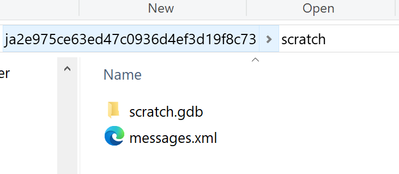

I am even seeing it create the jobs dir with a scratch folder in the arcgisjobs folder and even a scratch GDB but it does not use it.  I can find no way in script to find this jobs dir either?
