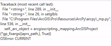

I'm trying to set a global variable containing the current APRX version.
glblcurVer = arcpy.mp.ArcGISProject("CURRENT").documentVersion
This works great for the most part except it gives me an OS error if I call this as part of the toolbox initialization.
Does anyone have any ideas for how to make this work? It's a variable used in a majority of the tools in this toolbox, so I'd prefer to not have to re-create it for each tool.
EDIT: My temporary work around is to call a function to set the global variable on each tool's initialization, rather than on the PYT. It appears to work so far, but I'm still open to ideas, here.

Yeah, what I did was like
globalvar1 = ""
globalvar2 = ""
def setglobals():
    code
    global globalvar1
    global globalvar2
    code
    return
class Tool:
    def __init__(self):
        """Define the tool (tool name is the name of the class)."""
        self.label = "Tool"
        self.description = ""
        setglobals()
It didn't work if I called setglobals() during the pyt initialization, but instead I just call it during each tool's initialization and it's worked so far.
