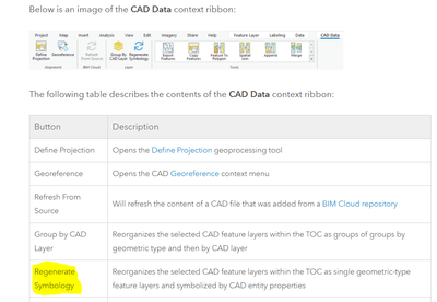

SumitMishra_016
you can try Regenerate Symbology
Also you can apply the same symbology as your source CAD using ArcGIS pro
