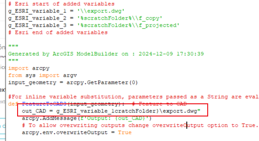

Hi everybody,
I am struggling to understand how a script that runs flawlessly in ArcGIS Pro can be flagged as having syntax errors after the publishing process. This inconsistency is both frustrating and highly problematic, as it disrupts workflows and undermines confidence in the publishing system throughout our customers. I believe this situation requires immediate investigation and resolution to ensure a smoother and more reliable user experience.

Yes it is a pain.  I have been battling it for weeks.  But you do have some things that can be fixed.
Never use the \\ notation when publishing.  Always use os.path.join().  But it almost looks like this is from model builder?  It should not use that notation either.
I use arcpy.env.scratchFolder instead of the % notation - again not sure if model builder did that.
My scripts are getting 15-20 var remaps which then makes publishing take 20 minutes or more.
In the end I gave up and use the old trick.  Comment out your entire script, publish, then go into the dir on the server and uncomment out the script.  This assumes you have server access which is really hard to get.  Then I still ran into issues with make raster layer and a few others like that work differently on server vs in Pro.  Even running the published tool in Pro or WAB also acts differently.  Just no consistency.

Hi Doug,
Yeah, it's a copy from a model but completely modified afterwards. Actually the % notation is the result after publishing, no matter what the staging/publishing process switches from arcpy.env.scratchFolder to %scratchFolder%.
Fortunately I have access to the server machine and I can fix it on the fly. But as you said, it's a constant pain. It's tough to get it done properly even with all the known tips & tricks .
IMHO, I rather get an error message when executing the tool because you missed something than this automated mess on the scripts... (deep sigh)

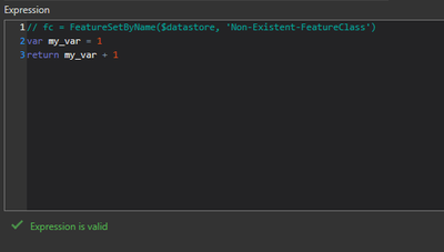

Semi-related to this, but attribute rules on file geodatabases have their comments parsed when you save the rule, but not when you validate:
HaydenWelch_0-1734442018691.pngHaydenWelch_0-1734442018691.pngHaydenWelch_1-1734442032153.pngHaydenWelch_1-1734442032153.png
Meaning you can't just comment out code that doesn't work, you have to delete it.
