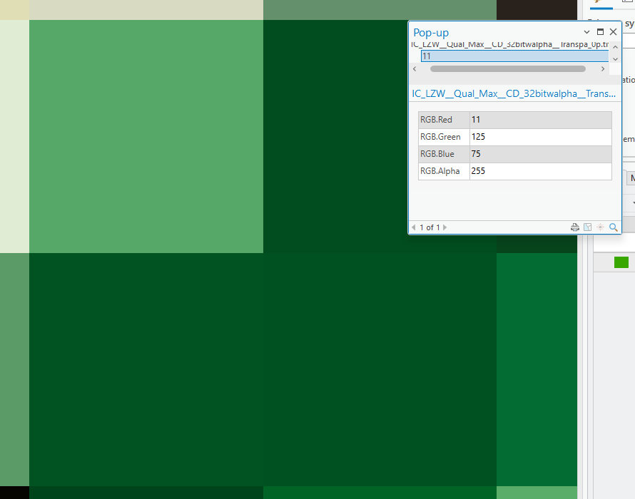

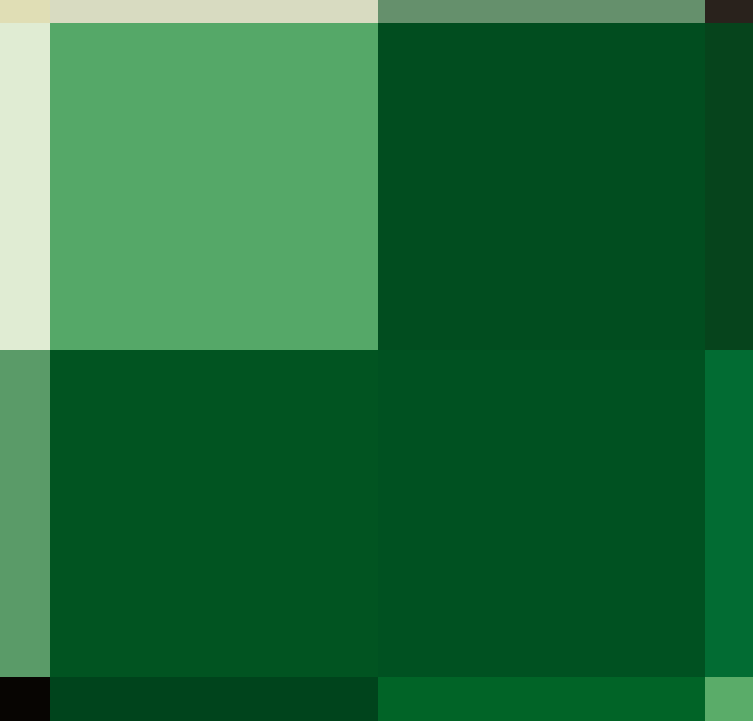

The output, green_filtered, is compared to the input raster using ArcGIS Pro. See screenshot, showing the input raster, zoomed in to show four whole cells:
Identify is run on the top-right cell:

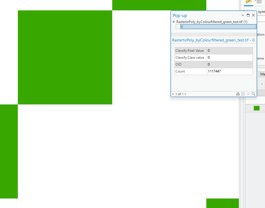

This shows a value of 125 for the green band. This is within the range GREEN_RANGE used in the Con tool. As such, this cell's value of 125 should be returned in the green_filtered output raster. However, inspecting this same cell in the output raster, its value is zero:
What is the error in the code or the approach?
