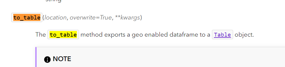

Using geoaccessor method to_table() and to_featureclass()
do not set a PRIMARY KEY (PK) in the enterprise geodatabase.  A PK is required to reflect tables as orm declarative tables with SQLAlchemy's automap_base.  This is why I want to set a PK.
