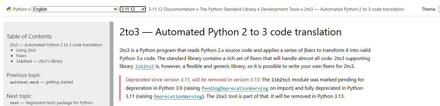

according to the docs that lib2to3 .....
Deprecated since version 3.11, will be removed in version 3.13:

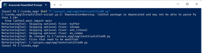

Pro 3.5 will ship with python 3.11.11
The above image is my 3.13 environment and the utility is still around
... sort of retired...

Ah, the Conda environments have it?
Turns out I was looking in the C Drive.  So ArcGIS must bundle with it included then?  (I tested the tool btw and did get some feedback, so I admit I found that a bit confusing)  So if ESRI keeps including it it should be fine. Thank you.
