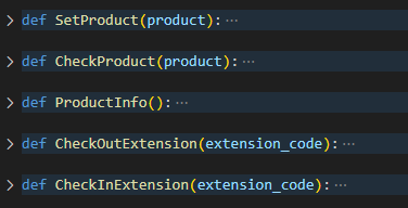

Those are the functions in the __init__.py for arcpy that do the license checks. They all pass arguments to the program so if the program isn't accessible from your current environment arcpy's import will fail.
