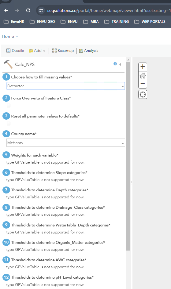

Hey hey!  So we have created a complex python script that that leverages multiple feature classes and various attributes.  We are essentially building a modeling tool that allows scientist to enter variable values for each attribute from a given feature class.  The model will then run with said varibales defined and select polygons that meet this criteria.  It works flawlessly in ArcGISPro.  Our goal was to publish this as a geoprocessing service and expose it through the geoprocessing widget (via rest end point) so that these scientist can access it through a web application easily without the need for firing up ArcGIS Pro.  When we publish and deploy to the web app, we get the following error for each of the variables... typeGPTableValue is not supported for now.

  • While running the tool, when we input a parameter under 'Variable Name' we receive a message under 'Weights for each variable': typeGPValueTable is not supported for now.

Sadly it's exactly what is seems like, The GPValueTable parameter is not implemented in the geoprocessing widget yet.
There is a REST implementation, but that means you'll have to move away from the widget and build a REST interface for the tool.
