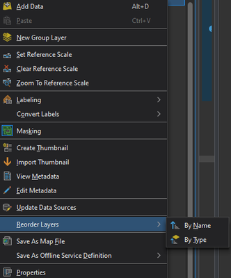

Is this not an option? If you need to automate it, you can use the mapping module.

HusamOqer
It wasn't an option as I wanted to automate this, the script worked thank you so much!
