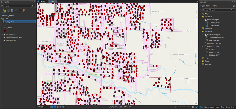

Hey everyone, the ESRI Community has been really helpful and would not be as far as I am with this code with you.  I do need help with this last bit though.
So the goal of this tool/code is to take the "Lines_Selected" line feature class and divide it up into two line feature classes based on their spatial relationship to my point feature classes.
The Lines_Selected feature class is created in the ForDeveloping.gdb and added to the map frame.
After this is done I want to divide it into two feature classes, based on the lines' spatial relationship to the point feature classes located in the NewHydrant.gdb.  They should be called Kuna4WS_StreetsExtracted and Middleton4WS_StreetsExtracted.
However the code I currently have just copies the Lines_Selected feature class from the map frame and saves it in the NewHydrants.gdb, which isn't what I'm wanting.  Here is the code that I am using, any help or suggestions is greatly appreciated, thank you!
