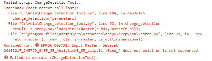

I have a script that is stored in a toolbox and ask for couple of parameters. when I run the script, it makes the process for the first image but after that it does not works for the next one and the following error appears:

RuntimeError: ERROR 000732: Input Raster: Dataset 20180607_145218_0f4e_3B_AnalyticMS_SR_clip.tif does not exist or is not supported
That type of error is the same that I got when I run the complete script.
