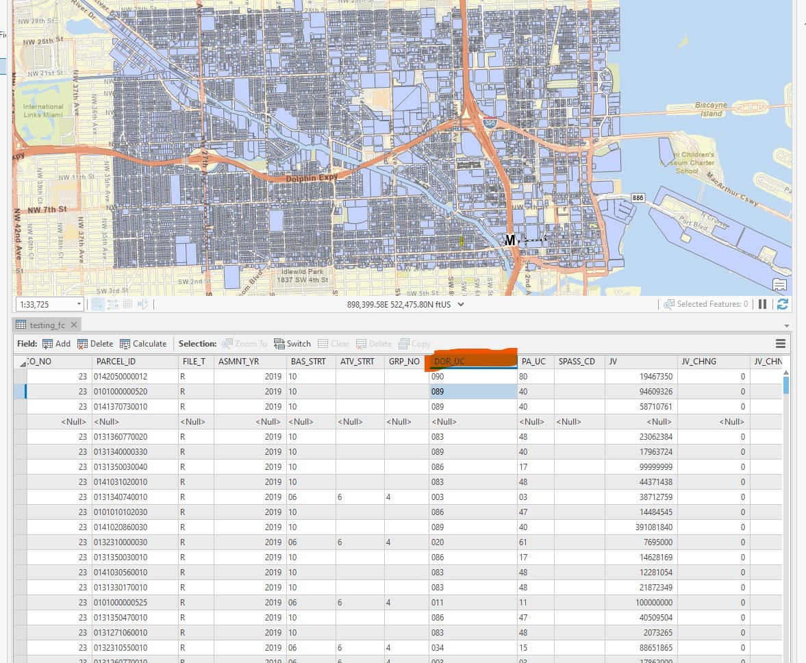

 Field DOR_UC currently has some codes that I need to convert into a sentence.
See image below for fc attribute's table:
Each of those codes has a meaning in the form of a sentence. I need to assign their meaning and delete the codes.
To do this I've created a dictionary where the key is the code and the value is the sentence (See attached csv).
To start testing the script I created a field called "TEST" where I want to put the value part of the dictionary.
So the code would go something like this:
If a feature in field DOR_UC is equal to 000 then the feature value in field TEST would be "Vacant Residential  - with/without extra features".
When I try to run the code I am getting this first error:
  File "D:/APRX_MXDS/USA_Parcels_2019_Project/Scripts/Dictionary Key() method_2.py", line 44, in <module>
    for row in cursor:
RuntimeError: A column was specified that does not exist.
The weird thing is that I have both of the columns.
Not sure how to solve this.
Also, not sure if the overall code has more errors.
Could someone help me with this? I need to finish this today and I have no idea on how to continue.

NataliaGutierrez1
I understand that is the error but the column name is correct and it exists in my feature class.
I even include a line of code in my script that prints all of the field names. When I run the line of code it prints out the field names that supposedly don't exist.
NataliaGutierrez1
I even include the image containing the field/column name in the attribute table of my feature class.
